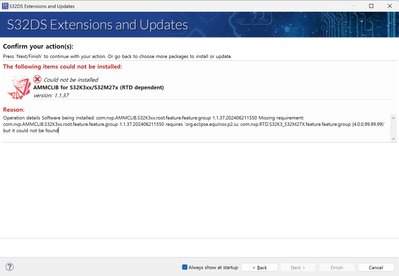

I have a install problem about AMMCLIB update.
The problem is The following items could not be installed. AMMCLIB for S32K3xx/S32M27x (RTD dependent)
Reason : Operation details Software being installed: com.nxp.AMMCLIB.S32K3xx.root.feature.feature.group 1.1.37.202406211550 Missing requirement: com.nxp.AMMCLIB.S32K3xx.root.feature.feature.group 1.1.37.202406211550 requires 'org.eclipse.equinox.p2.iu; com.nxp.RTD.S32K3_S32M27X.feature.feature.group [4.0.0,99.99.99)' but it could not be found
What can i do for this problem.

As the error message express, you are missning RTD for this device.
It is RTD dependent.
First install RTD.S32K3_S32M27X package and then install AMMCLIB.
You will find it in your NXP SW account:
Or you can get to the same location via S32K3 web page:
https://www.nxp.com/webapp/swlicensing/sso/downloadSoftware.sp?catid=SW32K3-STDSW-D

Hello, Peter
Thanks to you, I was able to solve this problem. It works well.
