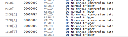

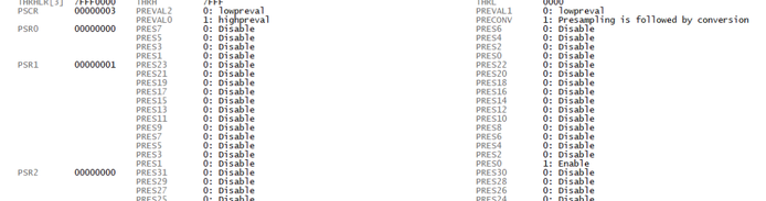

I am trying to perform ADC conversion for precision input and standard input channels for S32K342 device with the following configurations.
  • Presample Enabled for each channel
  • Bypass sample enbled for whole HW unit
  • PREVAL - 0(VREFL)
OBSERVATION:
  • Observed PREVAL values in result register for the respective ADC channels.
    • if PREVAL - 1, Result registers are HIGH
    • if PREVAL - 0, Result register values are zeroes.

Hi @Venu_M,
This is a correct observation.
When PSCR[PRECONV] = 0, pre-samling is followed by sampling and conversion.
When PSCR[PRECONV] = 1, pre-samling is followed by conversion.
RM, Section 61.3.9 Presampling
BR, Daniel

Venu_M
Hi @danielmartynek ,
I am trying to get correct conversion data with PSCR[PRECONV] = 1. Not able to get the correct data.
Venu
2,050件の閲覧回数
danielmartynek
Hi @Venu_M,
These are the correct data.
When PRECONV = 1, the sampling on the actual input channels is skipped.
BR, Daniel
