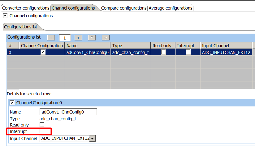

I registered ADC interrupt, but it is never getting triggered.
I have battery input connected to ADC1 with channel 2, I am able to see battery value is changing but there is no ADC interrupt triggered.
ADC1 is the device and channel is 2.
Code Snippet:
ADC_DRV_ConfigConverter(1, &adConv1_ConvConfig0);
adConv1_ChnConfig0.channel = 2;
/* Configure ADC channel and software trigger a conversion */
ADC_DRV_ConfigChan(1, 0U, &adConv1_ChnConfig0);
/* Wait for the conversion to be done */
ADC_DRV_WaitConvDone(1);
/* Store the channel result into a local variable */
ADC_DRV_GetChanResult(1, 0U, &adcRawValue);

/* Install ADC ISR */
INT_SYS_InstallHandler(ADC1_IRQn, &ADCISR, NULL);
/* Enable ADC interrupt */
INT_SYS_EnableIRQ(ADC1_IRQn);
void ADCISR(void)
Can someone please review this and guide me.

3,571 Views
danielmartynek
Did you enable interrupts in the ADC driver?
3,571 Views
mrajanna
Contributor V
Hi Daniel,
On every ADC conversion, it seems interrupt is getting triggered.
Can you please guide me to trigger the interrupt only on certain value change.
Mohan

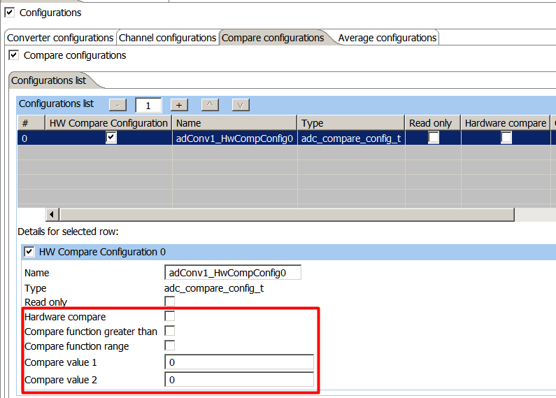

3,571 Views
danielmartynek
Hi Mohan,
The compare function is described in Chapter 39.5.5 of the RM. There are six compare modes configurable in SC2 register. And the result is compared to CV1-2 values.
3,571 Views
mrajanna
Contributor V
Thanks Daniel.
Interrupt is now triggering for that particular ADC channel.
