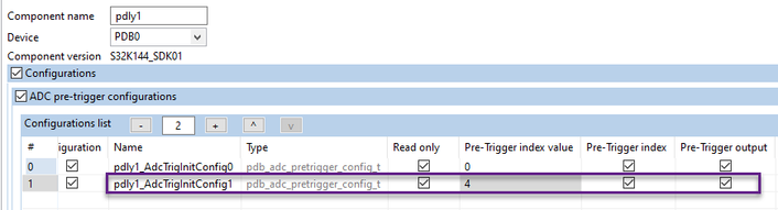

I use the ADC hardware trigger example for S32K144 to read ADC using the PDB trigger.
Is it possible to selectively read ADC channels using a hardware trigger?
I have supplemented the ADC hardware trigger example with additional channel 4. The changes are shown in red:

adc_chan_config_t adConv1_ChnConfig0 = {
.interruptEnable = true,
.channel = ADC_INPUTCHAN_EXT12,
adc_chan_config_t adConv1_ChnConfig1 = {
.channel = ADC_INPUTCHAN_EXT10,

ADC_DRV_ConfigConverter(ADC_INSTANCE, &adConv1_ConvConfig0);
ADC_DRV_AutoCalibration(ADC_INSTANCE);
ADC_DRV_ConfigChan(ADC_INSTANCE, 0UL, &adConv1_ChnConfig0);
ADC_DRV_ConfigChan(ADC_INSTANCE, 4UL, &adConv1_ChnConfig1);

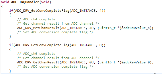

1. I can see ADC_IRQHandler being triggered, but cannot find a way to get the channel number for which the ADC is triggered for. Is it possible to get the ADC channel number in the ADC_IRQHandler?
2. Will the ADC_IRQHandler be triggered only for channels 0 and 4 or it will span over all the channel from 0 to 4?

1.
You can read the flags like this:
2.
Yes you can select which ADC channels get triggered.
In the example above, ADC0_ch0 is triggered when PDB_CNT == delayValue/2, and ADC0_ch4 when PDB_CNT == delayValue.
NOTE:
In the example, the adcConvDone flag can be set only once both ADC results are ready.
Otherwise it would trigger the PDB again before the ADC conversion is complete.
