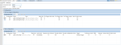

I use the ADC hardware trigger example for S32K144 to read ADC using the PDB trigger.
Is it possible to selectively read ADC channels using a hardware trigger?
I have supplemented the ADC hardware trigger example with additional channel 4. The changes are shown in red:

Could people from NXP clarify the following questions?
1. I can see ADC_IRQHandler being triggered, but cannot find a way to get the channel number for which the ADC is triggered for. Is it possible to get the ADC channel number in the ADC_IRQHandler?
2. Will the ADC_IRQHandler be triggered only for channels 0 and 4 or it will span over all the channel from 0 to 4?
3. Is there a good and simple manual to better understand the ADC hardware working logic when it is coupled with PDB?
Thanks a lot for any clarification.

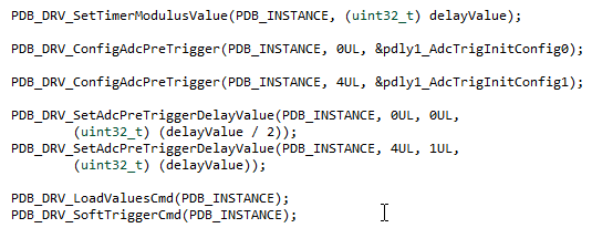

Hello @davithakobyan,
1.
You can read the flags like this:
2.
Yes you can select which ADC channels get triggered.
In the example above, ADC0_ch0 is triggered when PDB_CNT == delayValue/2, and ADC0_ch4 when PDB_CNT == delayValue.
NOTE:
In the example, the adcConvDone flag can be set only once both ADC results are ready.
Otherwise it would trigger the PDB again before the ADC conversion is complete.
