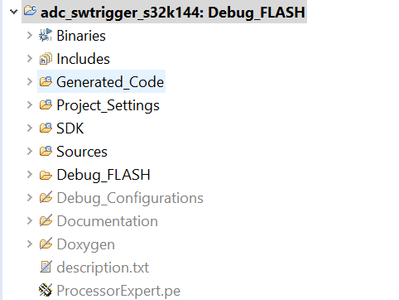

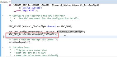

Hi Team,
i want to do ADC calibration for S32k144 for accuracy. can you provide/suggest any example for how to implement it in code and how to calculate TUE.
gargi
1 返信
1,057件の閲覧回数
Senlent
Hi@Gargi2021
please take a look at the following demos,this demo in S32 DS Studio,
regarding the TUE,i found some answer that might help you.
https://community.nxp.com/t5/S32K/ADC-Tue-and-resolution/m-p/1328326
