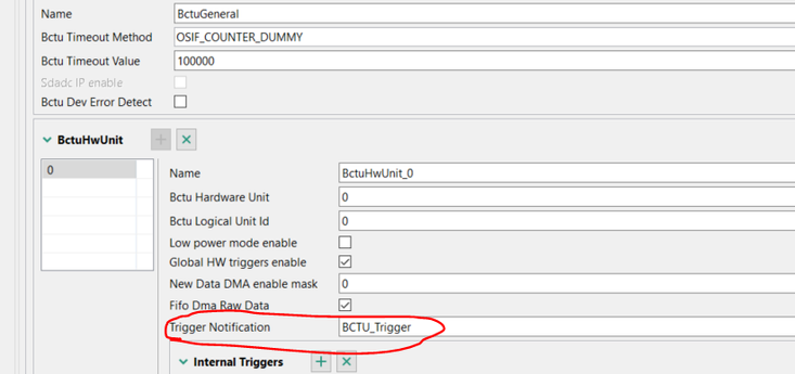

5 ) When you say “BCTU Trigger notification,” do you mean trigger notifications? I just need to be sure.
Ayaz_0-1737364261670.png or
6 ) Is there a difference in sampling time between sampling the precision ADC pins and the standard ones?
The main purpose of this test is to ensure that all signals are read correctly without overlapping. Additionally, it aims to offset the triggering of ADC1 and ADC2 so that each signal is sampled while other ADC conversions are off, thereby achieving the best ADC reading performance.
But if I can't get the correct BCTU Trigger notification, so it not possible to do perform this test .
yes, in your project is "BCTU_Trigger"
