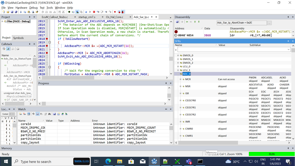

I'm working with S32K324 controller. During ADC initialization read/write to ADC MCR register restricted. While executing that line code will go to infinite loop. in SFR registers it is mentioned as can't access. I'm new to this controller. If anyone has any idea, please help. Screenshot attached. MicrosoftTeams-image (2).png

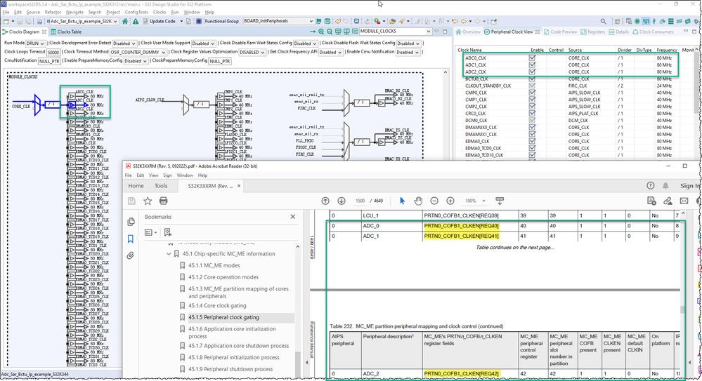

Hi Sruthi,
When I try to debug the Adc_Sar_Bctu_Ip_example, it will not go to infinite loop when run Adc_Sar_Ip_Init. Did you enable the clock gate of ADC?
