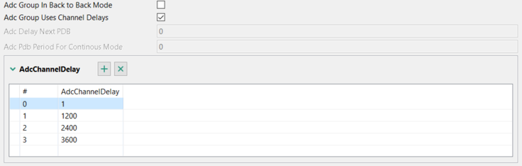

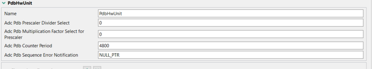

Hi@Anthony_PAT_EFI
I made a PDB trigger ADC routine with reference to "Adc_example_S32K144", you can refer to it.
The hardware is S32K144EVB and RTD Version is 1.0.1.
10K = 48MHz/4800
PDB delay time:
3,372 Views
