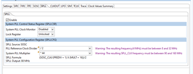

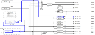

2. I configured the mcu with 48MHZ FIRC , 8 MHZ  SIRC and 40 MHZ SOSC (RUN MODE). System clock selector (FIRC_CLK). SPLL is disabled . check the below screenshot.
3. Now in RUN mode (without SPLL), I can achieve upto 48 MHZ with FIRC. My question is If I want to achieve 80 MHZ what configuration I have to do.
4. SPLL CLK min is 90 MHZ and My MCU max clock is 80MHZ. So I disabled the SPLL.

The output frequency of the SPLL must be in range of 180 MHz - 320 MHz, the ones that can be configured in 80MHz are the SPLLDIV1_CLK and SPLLDIV2_CLK.
Refer to the image below which shows the settings I made:

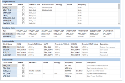

VaneB
Hi @sarwath
See section 27.3 Clock definitions of the S32K1xx MCU Family - Reference Manual
Regarding to the configuration of the clocks I suggest you use the Cloks tool from ConfigTools included in S32DS 3.4, where you can try different configurations to obtain the desired values.

My S32K144 part number (FS32K144HFT0MLLR), its max clock speed is 80 MHZ. Currently I am configured to 48MHZ by FIRC_CLK.
I tried to configure 80 MHZ with SPLL but I got warning due to SPLL min and max frequency. If I want achieve the 80 MHZ what configuration I have to do in processor expert clock settings.

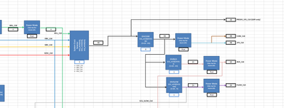

VaneB
Hi @sarwath

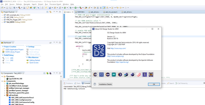

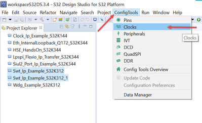

Thanks @VaneB  . I'm just curious which IDE you're using. I'm using the S32DS IDE, and I don't see any clock setting GUIs like yours.
5,944 Views
VaneB
Hi @sarwath
It is the clock tool included in Config Tools.
5,932 Views
sarwath
Hi @VaneB,
Why are my S32DS options so different from yours? I have the processor expert instead of config tools.
5,920 Views
VaneB
Hi @sarwath
It is because the version is S32 Design Studio 3.4 – Windows/Linux
