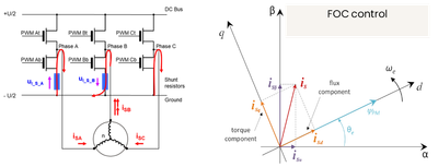

These examples demonstrate a 3-phase Permanent Magnet Synchronous Motor (PMSM) vector control (Field Oriented Control - FOC) drive with 2- shunt current sensing with and without position sensor. This design serves as an example of motor control design using NXP S32K3 automotive family. tomasfedor_0-1707464279910.png
