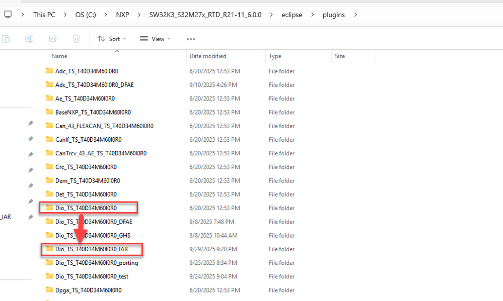

2.2.1 Copy one RTD MCAL new project
Open path
C:\NXP\SW32K3_S32M27x_RTD_R21-11_6.0.0\eclipse\plugins
Copy Dio_TS_T40D34M60I0R0 , rename it as Dio_TS_T40D34M60I0R0_IAR
Fig 1

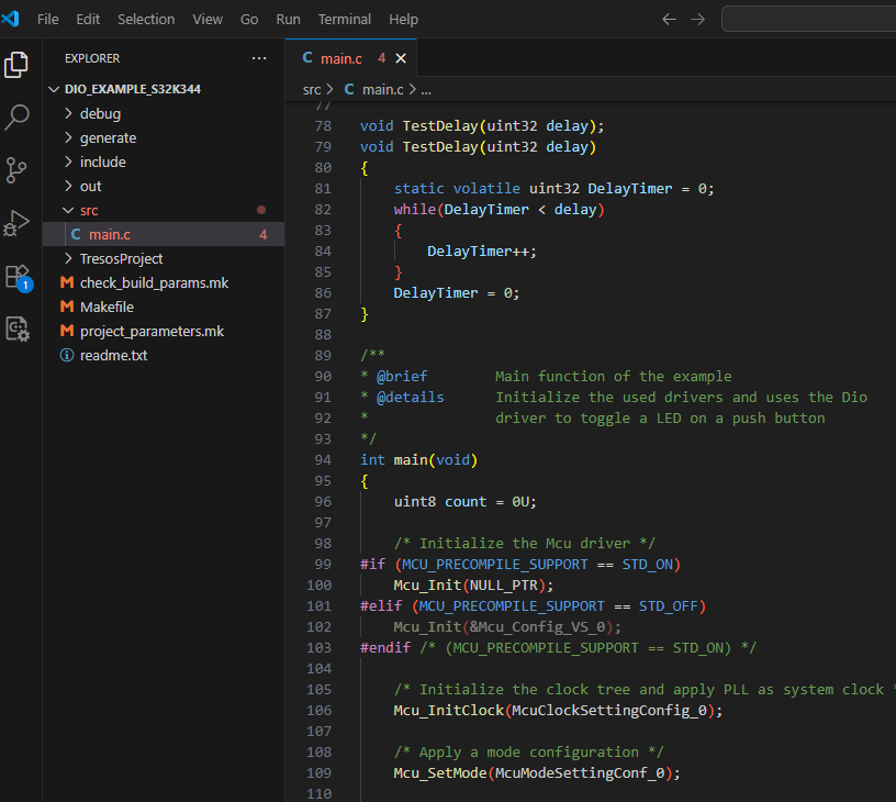

2.2.3 Vscode open Dio_TS_T40D34M60I0R0_IAR project
Use VS code open the following path folder:
C:\NXP\SW32K3_S32M27x_RTD_R21-11_6.0.0\eclipse\plugins\Dio_TS_T40D34M60I0R0_IAR\examples\EBT\S32K3XX\Dio_Example_S32K344
Of course, you can also directly open this folder path using the command line, as long as you ensure that it is in the same layer path as the. mk and makefile scr
Fig 3

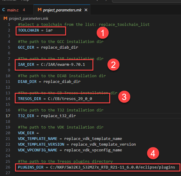

2.2.4   Project_parameters.mk modification
Mainly modify the following points:
TOOLCHAIN = iar
IAR_DIR = C:/IAR/ewarm-9.70.1
TRESOS_DIR = C:/EB/tresos_29_0_0
PLUGINS_DIR = C:/NXP/SW32K3_S32M27x_RTD_R21-11_6.0.0/eclipse/plugins
The path of IAR must be consistent with the version of IAR software used to ensure that the corresponding IAR compiler can be found.

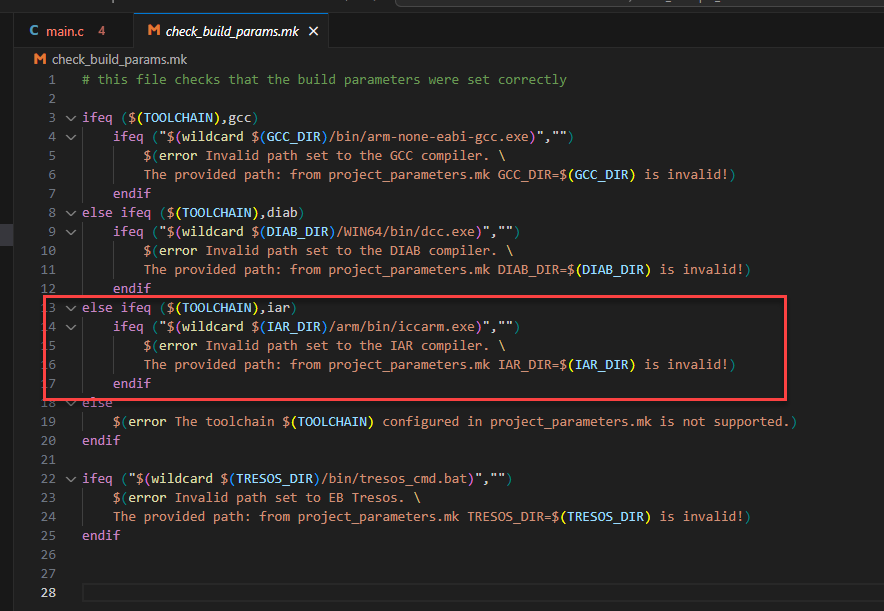

2.2.5   Check_build_params.mk modification
Add the following content to check_build_params.mk:
else ifeq ($(TOOLCHAIN),iar)
    ifeq ("$(wildcard $(IAR_DIR)/arm/bin/iccarm.exe)","")
        $(error Invalid path set to the IAR compiler. \
        The provided path: from project_parameters.mk IAR_DIR=$(IAR_DIR) is invalid!)
Endif

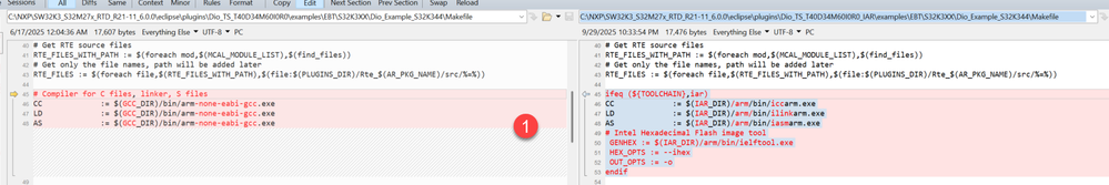

2.2.6        Makefile modification
  Makefile need the following 5 points modification:
(1)Compilier change
ifeq (${TOOLCHAIN},iar)
CC             := $(IAR_DIR)/arm/bin/iccarm.exe
LD             := $(IAR_DIR)/arm/bin/ilinkarm.exe
AS             := $(IAR_DIR)/arm/bin/iasmarm.exe
# Intel Hexadecimal Flash image tool
 GENHEX := $(IAR_DIR)/arm/bin/ielftool.exe
 HEX_OPTS := --ihex
 OUT_OPTS := -o
endif

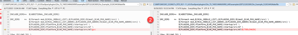

(2) SRC_DIRS  add TOOLCHAIN
SRC_DIRS    +=  $(foreach mod,$(MCAL_MODULE_LIST),$(PLUGINS_DIR)/$(mod)_$(AR_PKG_NAME)/src) \
                $(foreach mod,$(MCAL_MODULE_LIST_ADDON),$(PLUGINS_DIR_ADDON)/$(mod)_$(AR_PKG_NAME_ADDON)/src) \
                $(PLUGINS_DIR)/Platform_$(AR_PKG_NAME)/startup/src \
                $(PLUGINS_DIR)/Platform_$(AR_PKG_NAME)/startup/src/m7 \
               $(PLUGINS_DIR)/Platform_$(AR_PKG_NAME)/startup/src/m7/$(TOOLCHAIN)
Fig 7

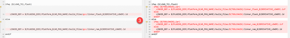

(3) Linker file  modification
ifeq ($(LOAD_TO),flash)
    LINKER_DEF:= $(PLUGINS_DIR)/Platform_$(AR_PKG_NAME)/build_files/${TOOLCHAIN}/linker_flash_$(DERIVATIVE_LOWER).icf
  else
    LINKER_DEF:= $(PLUGINS_DIR)/Platform_$(AR_PKG_NAME)/build_files/$(TOOLCHAIN)/linker_flash_$(DERIVATIVE_LOWER).ld
  endif
else
    LINKER_DEF:= $(PLUGINS_DIR)/Platform_$(AR_PKG_NAME)/build_files/$(TOOLCHAIN)/linker_ram_$(DERIVATIVE_LOWER).icf
  else
    LINKER_DEF:= $(PLUGINS_DIR)/Platform_$(AR_PKG_NAME)/build_files/$(TOOLCHAIN)/linker_ram_$(DERIVATIVE_LOWER).ld
  endif
endif
Fig 8

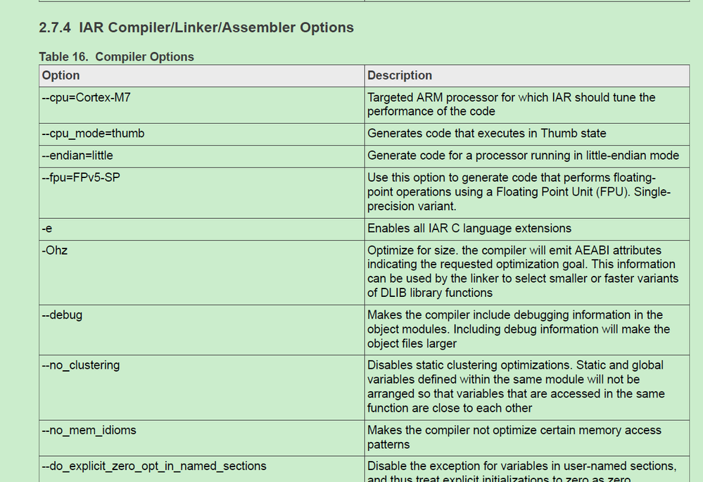

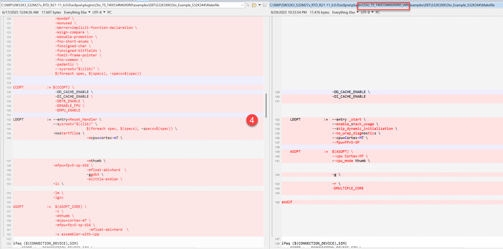

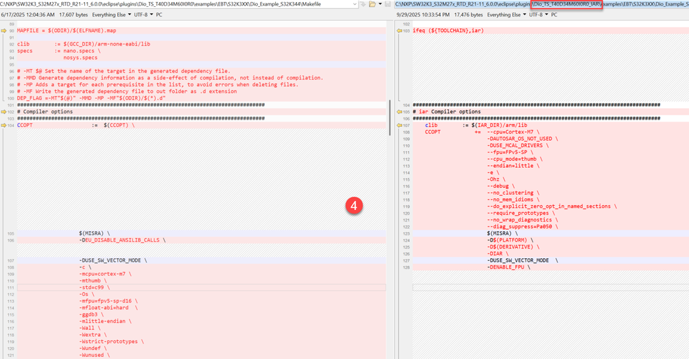

(4) Complier options change
# iar Compiler options
    clib        := $(IAR_DIR)/arm/lib
    CCOPT           +=  --cpu=Cortex-M7 \
                        -DAUTOSAR_OS_NOT_USED \
                        -DUSE_MCAL_DRIVERS \
                        --fpu=FPv5-SP \
                        --cpu_mode=thumb \
                        --endian=little \
                        -e \
                        -Ohz \
                        --debug \
                        --no_clustering \
                        --no_mem_idioms \
                        --do_explicit_zero_opt_in_named_sections \
                        --require_prototypes \
                        --no_wrap_diagnostics \
                        --diag_suppress=Pa050 \
                        $(MISRA) \
                        -D$(PLATFORM) \
                        -D$(DERIVATIVE) \
                        -DIAR \
                        -DUSE_SW_VECTOR_MODE  \
                        -DENABLE_FPU \
                        -DD_CACHE_ENABLE \
                        -DI_CACHE_ENABLE
    LDOPT           :=  --entry _start \
                        --enable_stack_usage \
                        --skip_dynamic_initialization \
                        --cpu=Cortex-M7 \
                        --fpu=FPv5-SP
    ASOPT           :=  $(ASOPT) \
                        --cpu Cortex-M7 \
                        --cpu_mode thumb \
                        -g \
                        -r \
                        -DMULTIPLE_CORE
endif
Fig 9
Fig  10
So how did these IAR compilation options come about? You can refer to the release note of RTD600, which contains corresponding descriptions

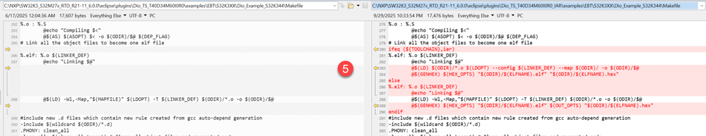

(5) Elf related change
%.elf: %.o $(LINKER_DEF)
              @echo "Linking $@"
              @$(LD) $(ODIR)/*.o $(LDOPT) --config $(LINKER_DEF) --map $(ODIR)/ -o $(ODIR)/$@@
              @$(GENHEX) $(HEX_OPTS) "$(ODIR)/$(ELFNAME).elf" "$(ODIR)/$(ELFNAME).hex"
else
              @echo "Linking $@"
              @$(LD) -Wl,-Map,"$(MAPFILE)" $(LDOPT) -T $(LINKER_DEF) $(ODIR)/*.o -o $(ODIR)/$@@
              @$(GENHEX) $(HEX_OPTS) "$(ODIR)/$(ELFNAME).elf" $(OUT_OPTS) "$(ODIR)/$(ELFNAME).hex"
endif
Fig 12

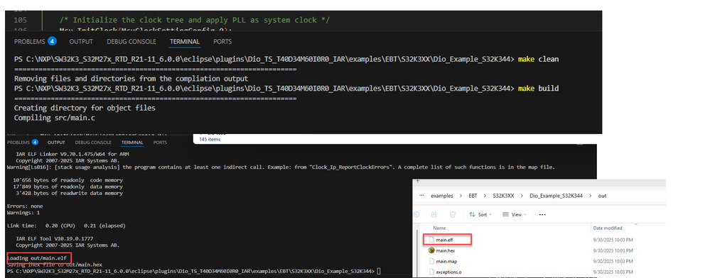

2.2.7   Build to generate elf
Commander:
make clean
make build
to generate the elf files:
Fig 13
After generation, the elf can be burned onto the S32K344 EVB board for testing. The test results show that the onboard red light is flashing, indicating that the IAR compiler can work in command-line mode.

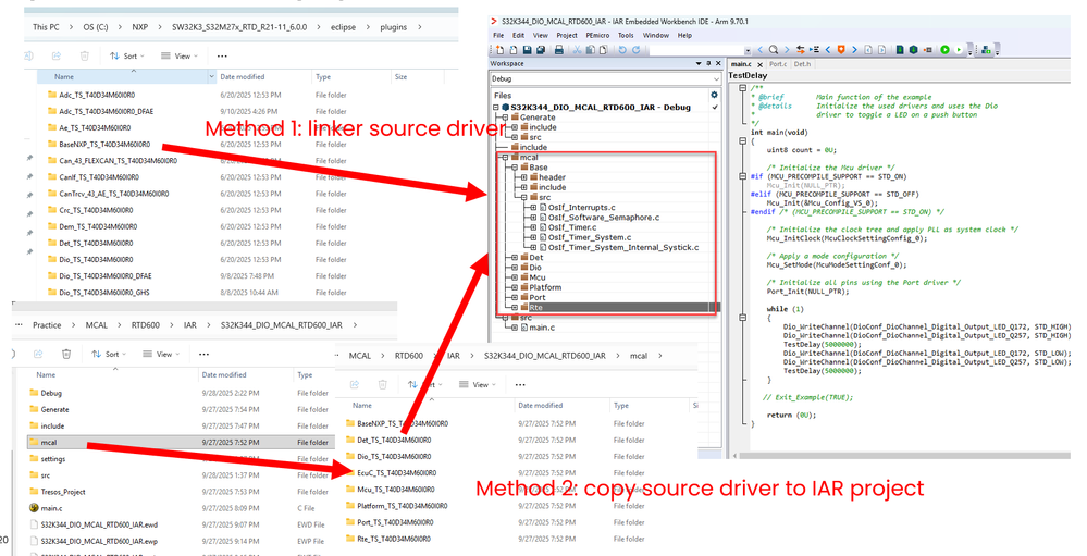

3.1 MCAL IAR IDE project 2 methods
Difference between two methods and how to import MCAL drivers:

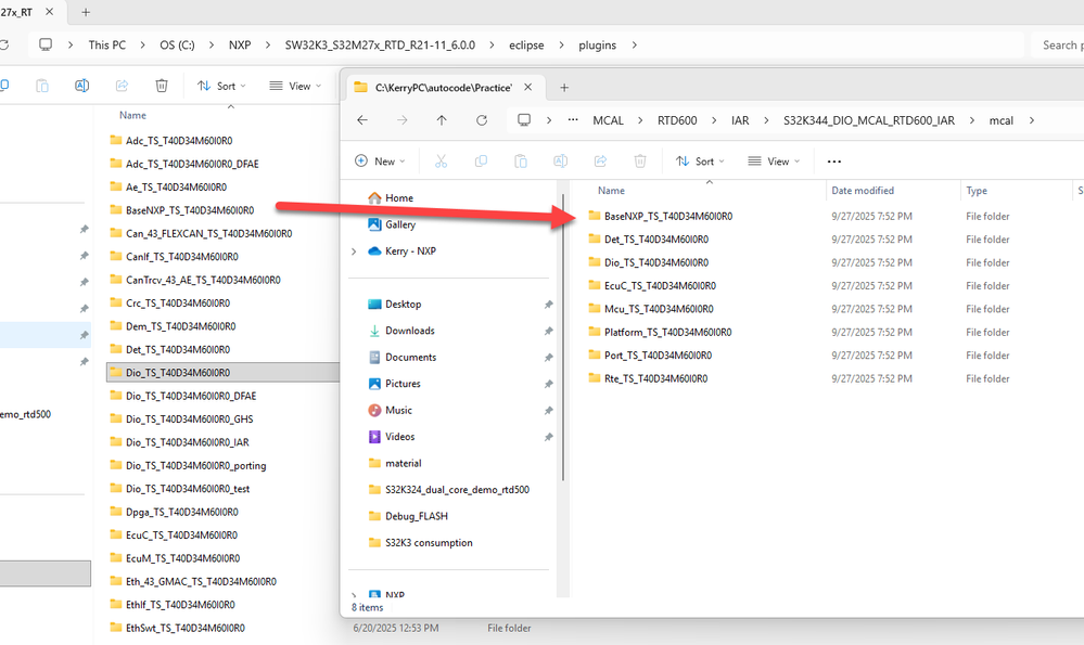

(1) Directly copy the RTD MCAL driver to the IAR IDE project directory
(2) Connect the IAR IDE project driver to the original RTD driver path
Fig 14

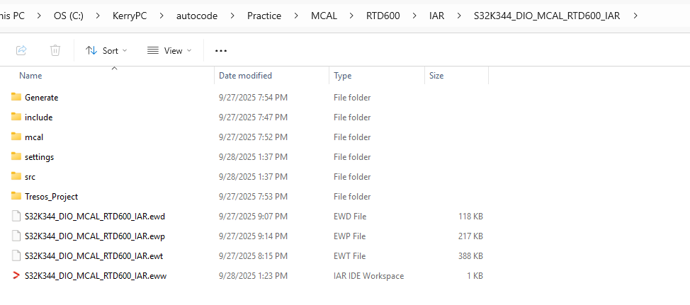

3.2.1 create the new RTD MCAL IAR project folder
   Create a new folder, named as:S32K344_DIO_MCAL_RTD600_IAR
3.2.2 create the sub folder for IAR project
      Generate:EB tresos project code
      Include:app related include file
      Mcal: mcal driver copy from RTD
      src: project main file
      Tresos_Project:EB tresos project
Fig 15

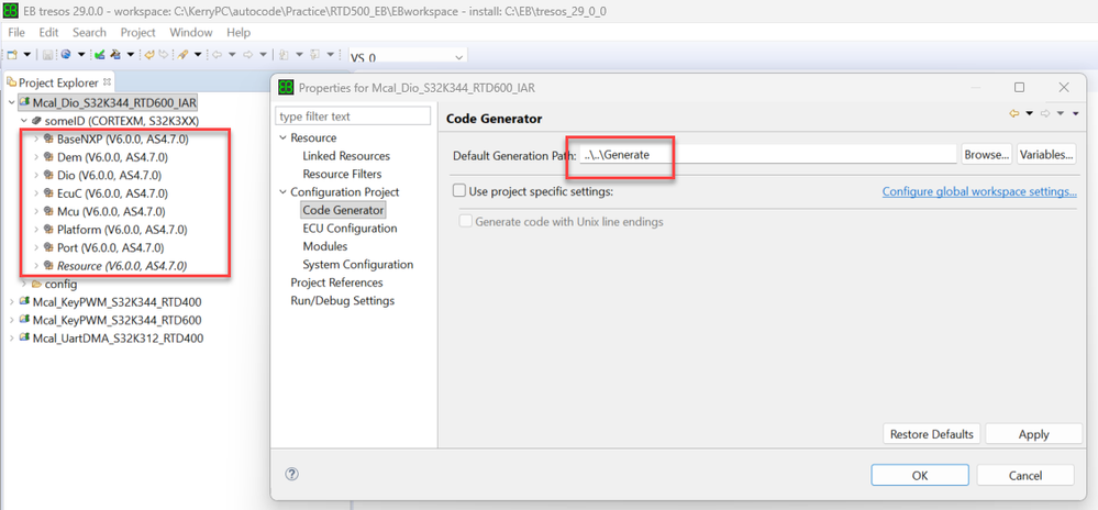

3.2.3 create EB tresos project
(1) Create the EB tresos project in the followign path:  S32K344_DIO_MCAL_RTD600_IAR\Tresos_Project\Mcal_Dio_S32K344_RTD600_IAR
(2)Add modules: BaseNXP, Dem, Dio, EcuC, Mcu, Platform, Port, Resource
(3)Copy RTD xdm files in the following path:
C:\NXP\SW32K3_S32M27x_RTD_R21-11_6.0.0\eclipse\plugins\Dio_TS_T40D34M60I0R0\examples\EBT\S32K3XX\Dio_Example_S32K344\TresosProject\Dio_Example_S32K344\config
to: S32K344_DIO_MCAL_RTD600_IAR\Tresos_Project\Mcal_Dio_S32K344_RTD600_IAR\config
(4)EB tresos Generate project
EB tresos code will be generated to folder:
S32K344_DIO_MCAL_RTD600_IAR\Generate
Fig 16
3.2.4 Copy RTD related drivers to IAR project folder
(1) BaseNXP: header, include, src
(2)Det:  include, src
(3)Dio:  include, src
(4)Mcu:  include, src
(5)Platform: build_files, include, src, startup
(6)Port: include, src
(7)Rte: include, src
Copy RTD folder to IAR project is one method, if don’t want to copy the file, also can use the linker to add the RTD install path drivers directly.
Fig 17

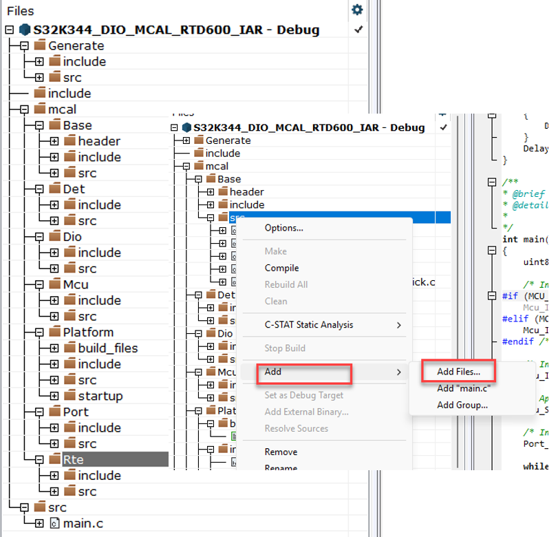

3.2.5 IAR IDE create IAR project
  (1) Project->Create new project
  (2) In the IAR project, add group
  The related folder in project can be structured like the fig 18, which contains:
  Generate: Include and src->EB tresos project generate code
  Mcal:  Base, Det, Dio, Mcu, Platform, Port, Rte->Mcal driver
  Src: Main.c->project main code
   (3) Add RTD mcal related drivers to IAR project
The RTD MCAL related driver files can be directly downloaded from the RTD installation path or copied to a folder in the IAR project, and both methods yield the same result.
Fig 18

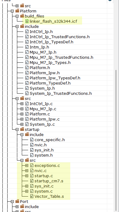

(4)IAR project platform folder added result:
Fig 19

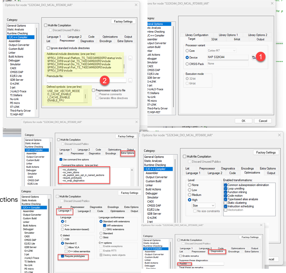

3.2.6 IAR project options configuration
(1)General options->Target->Device->NXP S32K344
(2)C/C++ Complier->Preprocessor
Addional include directories:
Use IAR project folder drivers which copied from RTD install path, the directories are
$PROJ_DIR$\Generate\include
$PROJ_DIR$\mcal\BaseNXP_TS_T40D34M60I0R0\header
$PROJ_DIR$\mcal\BaseNXP_TS_T40D34M60I0R0\include
$PROJ_DIR$\mcal\Mcu_TS_T40D34M60I0R0\include
$PROJ_DIR$\mcal\Platform_TS_T40D34M60I0R0\include
$PROJ_DIR$\mcal\Rte_TS_T40D34M60I0R0\include
$PROJ_DIR$\mcal\Platform_TS_T40D34M60I0R0\startup\include
$PROJ_DIR$\mcal\Det_TS_T40D34M60I0R0\include
$PROJ_DIR$\mcal\Dio_TS_T40D34M60I0R0\include
$PROJ_DIR$\mcal\Port_TS_T40D34M60I0R0\include
$PROJ_DIR$\include
If use the RTD install path drivers, use the following directories
C:\NXP\SW32K3_S32M27x_RTD_R21-11_6.0.0\eclipse\plugins\BaseNXP_TS_T40D34M60I0R0\header
C:\NXP\SW32K3_S32M27x_RTD_R21-11_6.0.0\eclipse\plugins\BaseNXP_TS_T40D34M60I0R0\include
C:\NXP\SW32K3_S32M27x_RTD_R21-11_6.0.0\eclipse\plugins\Mcu_TS_T40D34M60I0R0\include
C:\NXP\SW32K3_S32M27x_RTD_R21-11_6.0.0\eclipse\plugins\Platform_TS_T40D34M60I0R0\include
C:\NXP\SW32K3_S32M27x_RTD_R21-11_6.0.0\eclipse\plugins\Rte_TS_T40D34M60I0R0\include
C:\NXP\SW32K3_S32M27x_RTD_R21-11_6.0.0\eclipse\plugins\Platform_TS_T40D34M60I0R0\startup\include
C:\NXP\SW32K3_S32M27x_RTD_R21-11_6.0.0\eclipse\plugins\Dio_TS_T40D34M60I0R0\include
C:\NXP\SW32K3_S32M27x_RTD_R21-11_6.0.0\eclipse\plugins\Port_TS_T40D34M60I0R0\include
C:\NXP\SW32K3_S32M27x_RTD_R21-11_6.0.0\eclipse\plugins\Det_TS_T40D34M60I0R0\include
$PROJ_DIR$\include
Defined symbols:
S32K3XX
S32K344
IAR
USE_SW_VECTOR_MODE
D_CACHE_ENABLE
I_CACHE_ENABLE
ENABLE_FPU
Extra options:
--no_clustering
--no_mem_idioms
Languate 1:
  Check Require prototypes
Diagnostics
Suppress these disgnostics:
Pa050

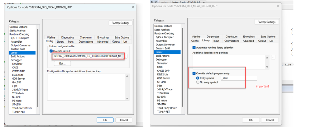

(3)Linker:
Two points need to be added:
$PROJ_DIR$\mcal\Platform_TS_T40D34M60I0R0\build_files\iar\linker_flash_s32k344.icf
Library->Entry symbols: _start
Fig 21

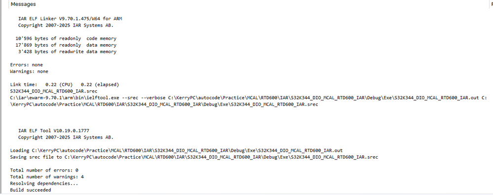

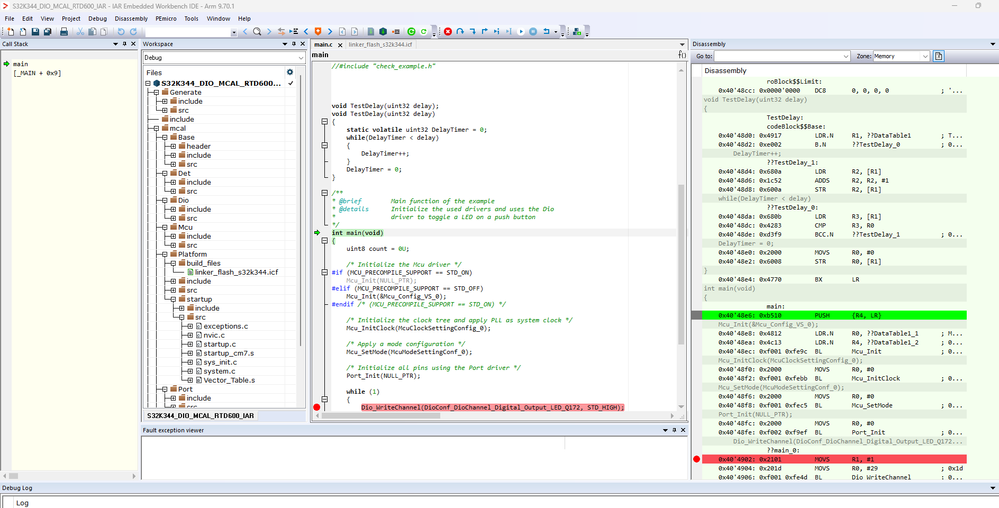

3.2.7  Build IAR project
Project->Rebuild All
Fig 23
3.2.8  Test result
Download and debug result:
Fig 24
After downloading and running, the red led is blinking on the board, indicating that the IAR IDE MCAL import method project has been successfully run.
