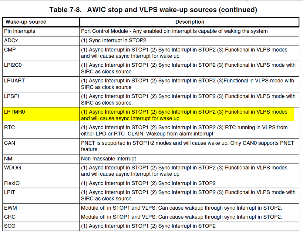

From S32KRM, it tells us that internal wakeup is achievable using LPTMR0.

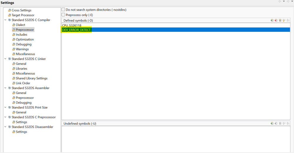

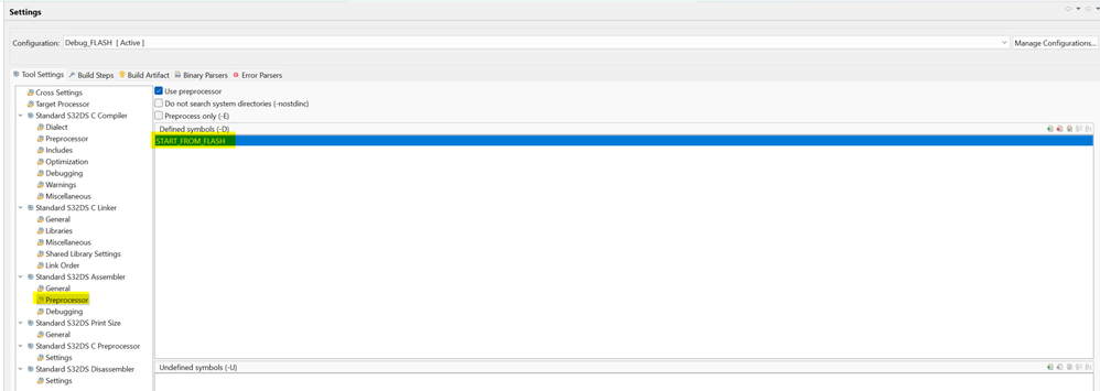

 Following symbols should be included if you are creating the project from scratch to properly put MCU to sleep and wakeup from POR.MACRO1.pngSymbol2.png
