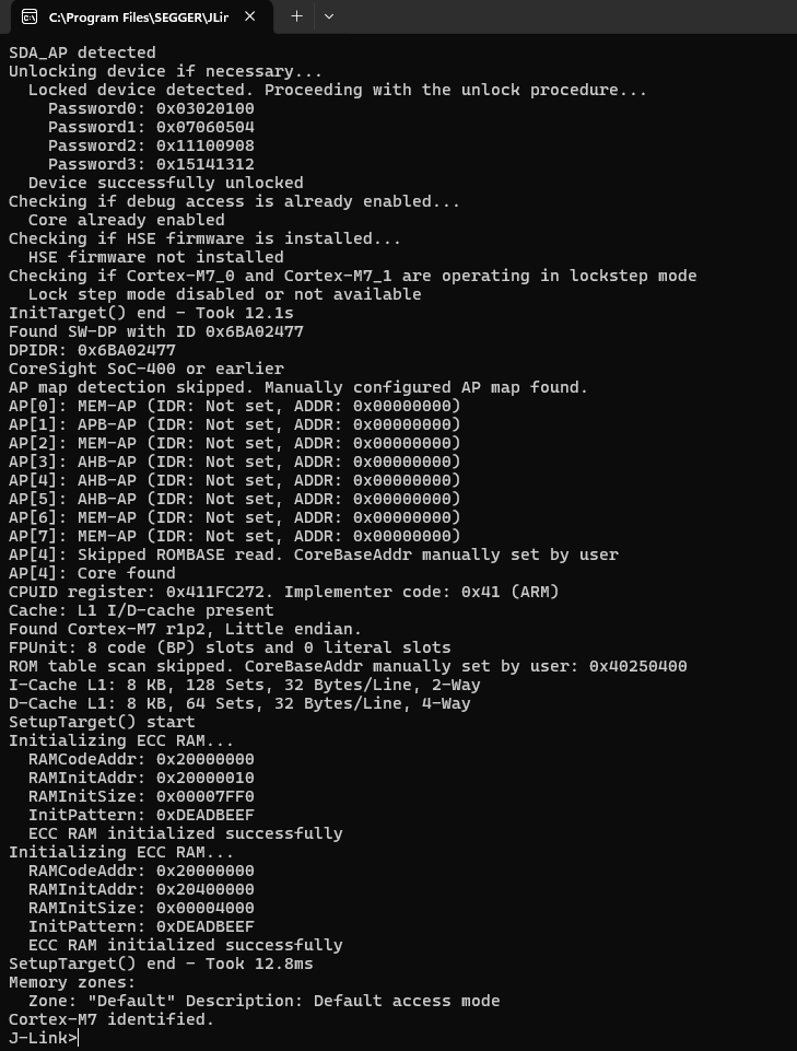

1. Abstract
The S32K3 chip has rich encryption functions. For encryption, an independent arm core is even allocated for HSE. HSE firmware needs to be installed separately. For the encryption debug interface, there are usually two ways:
  • Install HSE firmware to do static or dynamic secure
  • Do static secure without installing HSE firmware
The default chip does not install HSE firmware. In order to verify the secure debug, this article will use the RTD400HF01 version on the K312 chip to do static secure debug interface without installing HSE firmware. Other K3 chips are similar.

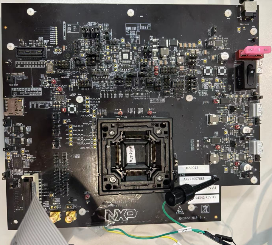

2. Hardware prepare
For the hardware, you can use any K3 board, such as the K312-EVB development board, or a self-developed board. In order to facilitate chip replacement in this article, an evaluation board with a socket is used:
 Fig 2
If need to configure to the K312, the board jumper need to do the following configuration:
J92:2-3,J28:2-3 ,J64:2-3  ,J114:2-3,J71:2-3  ,J118:2-3,J57:2-3 ,J72:2-3 ,J99:2-3

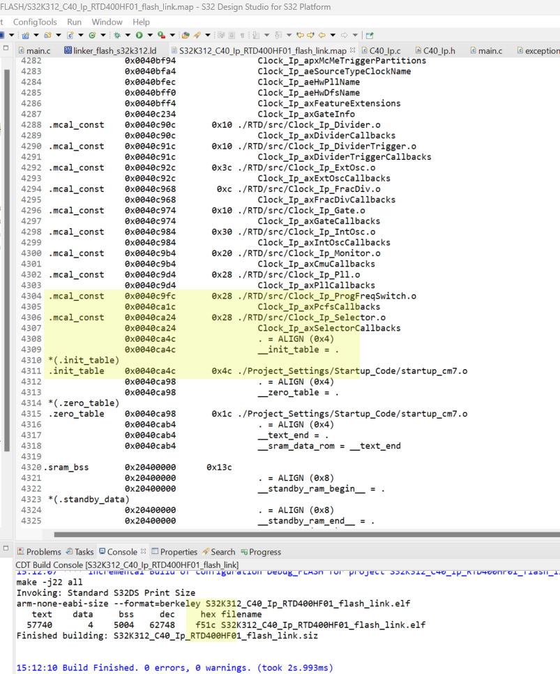

The purpose of doing this is to put all the functions in C40_Ip into RAM. After compiling, check the ramcode area in the map file:
 Fig 4
As you can see, after the above modification, all relevant C40 functions have been put into the internal RAM.
But please note that if you only do this and directly operate the flash, especially when erasing block0, hard fault will occur. You also need to wait for the FLASH controller to be idle.
Add a code to wait for the FLASH controller to be idle in main, and also put it in RAM. After operating the flash erase or write, call the function that waits for the FLASH controller to be idle. Before operating the flash code, you also need to call :

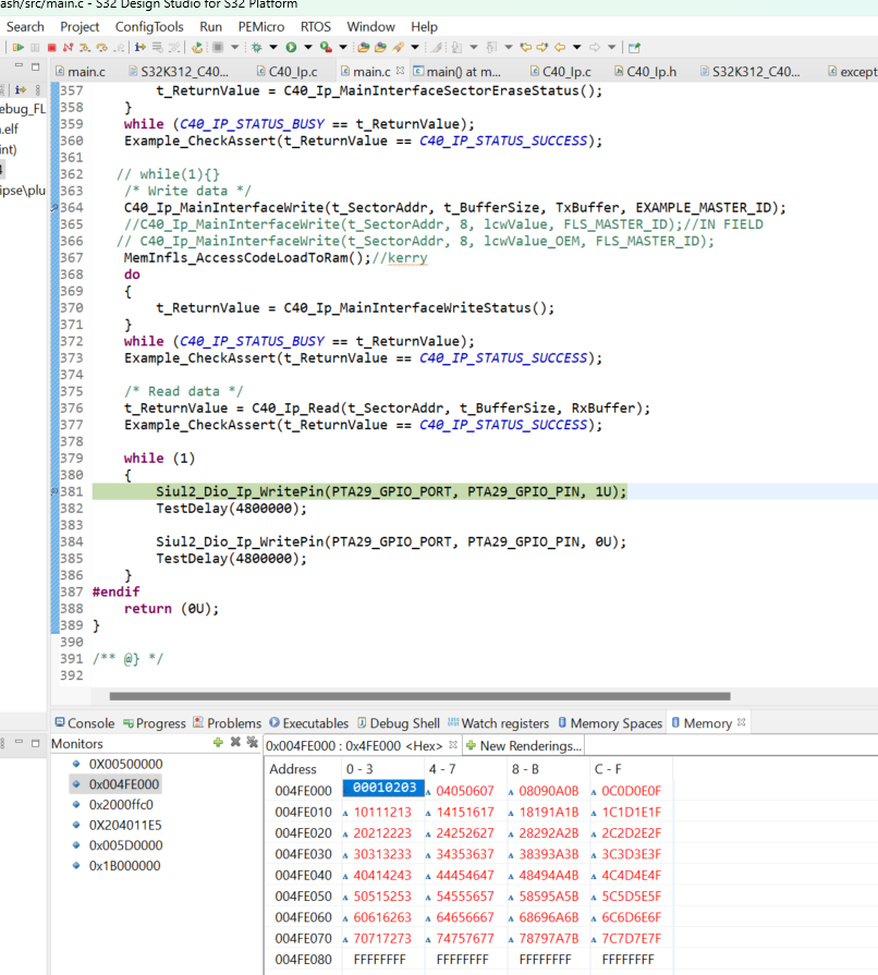

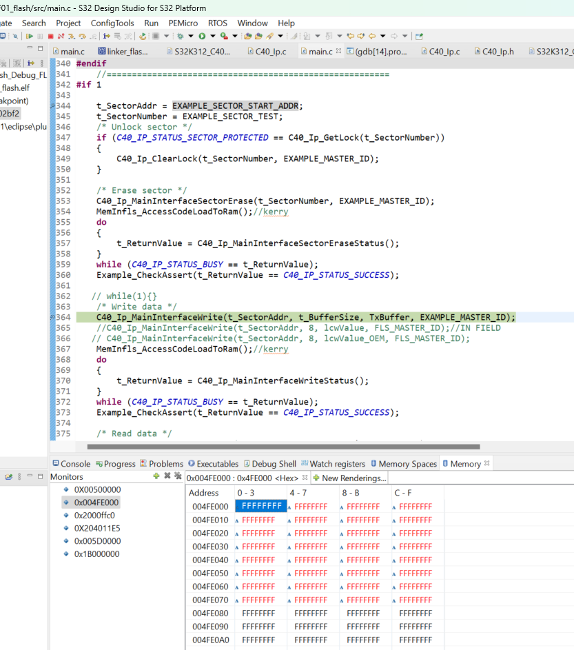

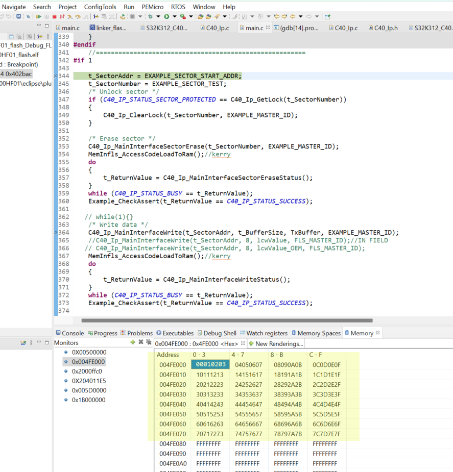

 Main code related erase and program is:
#define EXAMPLE_SECTOR_START_ADDR       (0x004FE000)
#define EXAMPLE_SECTOR_TEST              (C40_CODE_ARRAY_0_BLOCK_0_S127)
   C40_Ip_SetAsyncMode(FALSE);
    t_SectorAddr = EXAMPLE_SECTOR_START_ADDR;
    t_SectorNumber = EXAMPLE_SECTOR_TEST;
    /* Unlock sector */
    if (C40_IP_STATUS_SECTOR_PROTECTED == C40_Ip_GetLock(t_SectorNumber))
        C40_Ip_ClearLock(t_SectorNumber, EXAMPLE_MASTER_ID);
    /* Erase sector */
    C40_Ip_MainInterfaceSectorErase(t_SectorNumber, EXAMPLE_MASTER_ID);
    MemInfls_AccessCodeLoadToRam();
    do
        t_ReturnValue = C40_Ip_MainInterfaceSectorEraseStatus();
    while (C40_IP_STATUS_BUSY == t_ReturnValue);
    Example_CheckAssert(t_ReturnValue == C40_IP_STATUS_SUCCESS);
    /* Write data */
    C40_Ip_MainInterfaceWrite(t_SectorAddr, t_BufferSize, TxBuffer, EXAMPLE_MASTER_ID);
    do
        t_ReturnValue = C40_Ip_MainInterfaceWriteStatus();

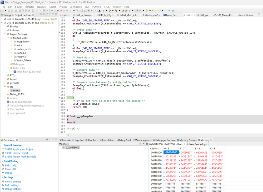

Compile the code, burn the code and test the results as follows:
 Fig 5
 Fig 6
 Fig 7

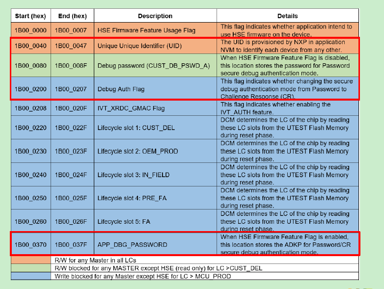

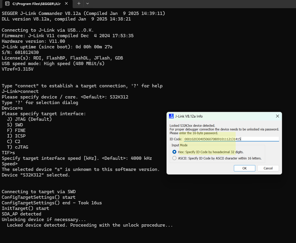

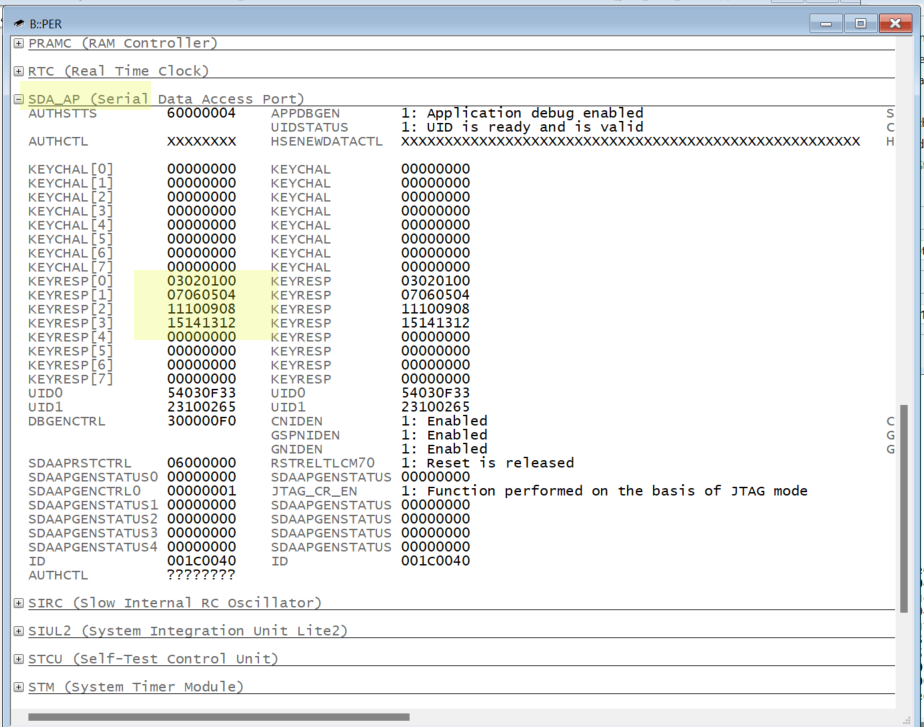

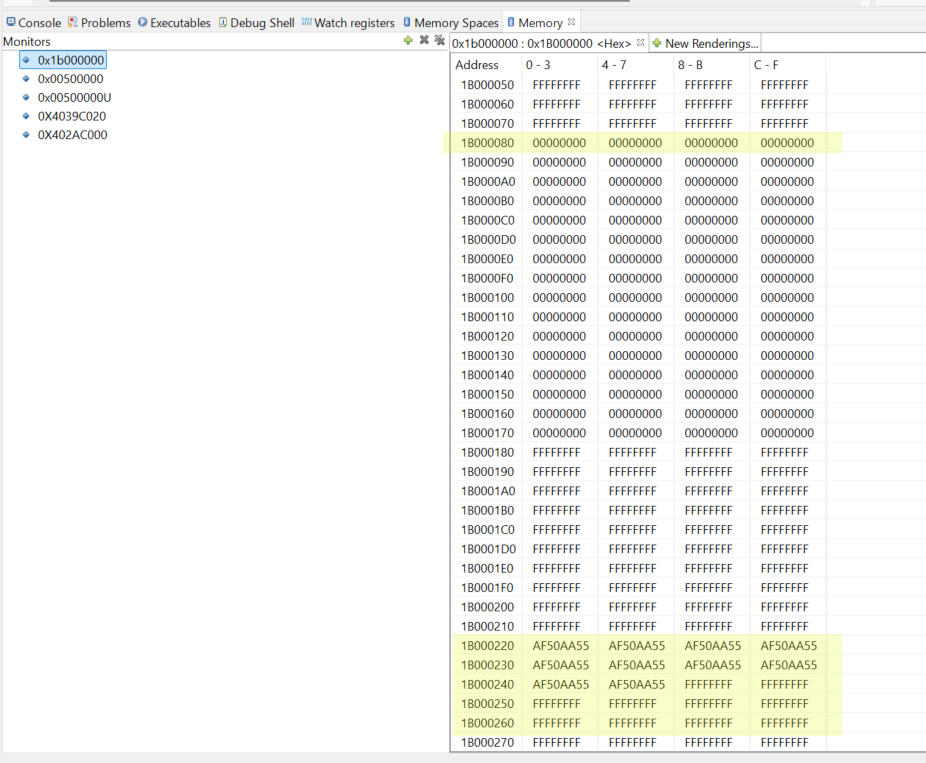

3.2  burn key to UTEST 0X1B000080
For secure debug, there are two static key addresses in the UTEST area: 0X1B000080, 0X1B000370.
0X1B000370 is the static encryption key address for use after the HSE firmware is installed. 0X1B000080 is the static encryption key address without HSE firmware.
 Fig 8
So the following operation needs to be performed to burn the key to the address of UTEST 0X1B000080. After the above flash preparation, it is very clear to burn the key, but there is no need to erase it. When it is determined that the key address is not all 0XFF, the key operation can be performed directly. The code is as follows:
Generate->include->C40_Ip_Cfg.h
#define C40_IP_MAX_VIRTUAL_SECTOR              (272U)//(271U)
If this is not modified, it will get stuck when executing sector C40_Ip_GetLock.
#define C40_UTEST_ARRAY_0_S000              (272U)    /* 0x1B000000 */
#define FLS_SECTOR_ADDR              0x1B000080U
#define FLS_SECTOR_TEST              C40_UTEST_ARRAY_0_S000
uint8 ADKP_Buffer[16]={0x00,0x01,0x02,0x03,0x04,0x05,0x06,0x07,
					   0x08,0x09,0x10,0x11,0x12,0x13,0x14,0x15};
    if( (IP_DCM->DCMLCC & 0x77) == 0x33 ) // check LC is CUST_DEL or not
#if 1
    //read the UTEST password data, if 0XFF, write.
    /* Read data */
    t_SectorAddr = FLS_SECTOR_ADDR;
    t_SectorNumber = FLS_SECTOR_TEST;
    t_ReturnValue = C40_Ip_Read(t_SectorAddr, 16, RxBuffer);
    KeyEmptyFlag = 1;
    for(uint32_t i=0; i<16; i++)
    	if(RxBuffer[i] != 0XFF)
    		KeyEmptyFlag = 0;
    		break;
    //write ADKP to UTEST, just write once!
    if(KeyEmptyFlag == 1)
        /* Unlock sector */
            C40_Ip_ClearLock(t_SectorNumber, FLS_MASTER_ID);
        /* Write data */
    	C40_Ip_MainInterfaceWrite(FLS_SECTOR_ADDR, 16, ADKP_Buffer, FLS_MASTER_ID);
    	MemInfls_AccessCodeLoadToRam();//kerry
        do
        //Power_Ip_PerformReset(&Power_Ip_HwIPsConfigPB);
#endif

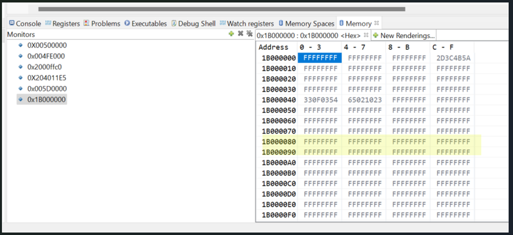

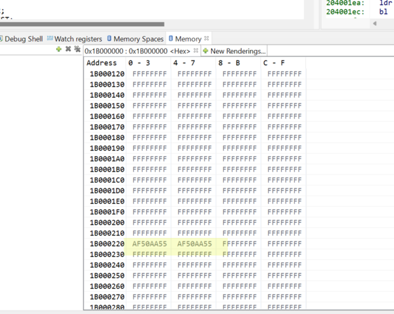

Test conditions before Key burning:
 Fig 9

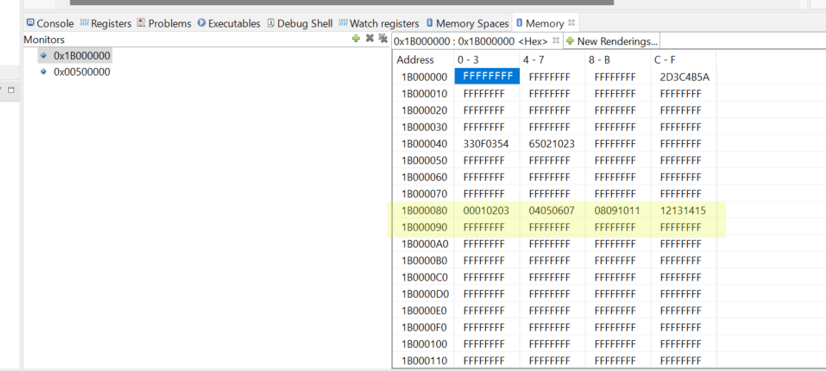

Test results after Key burning:
 Fig 10
It can be seen that key: HEX 00010203040506070809101112131415 is successfully burned into the UTEST 0X1B000080 area.

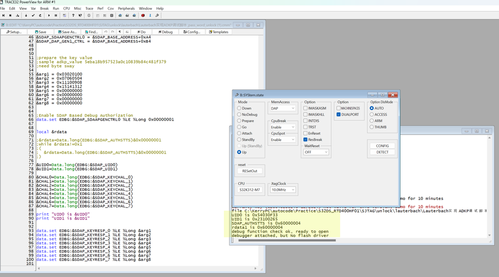

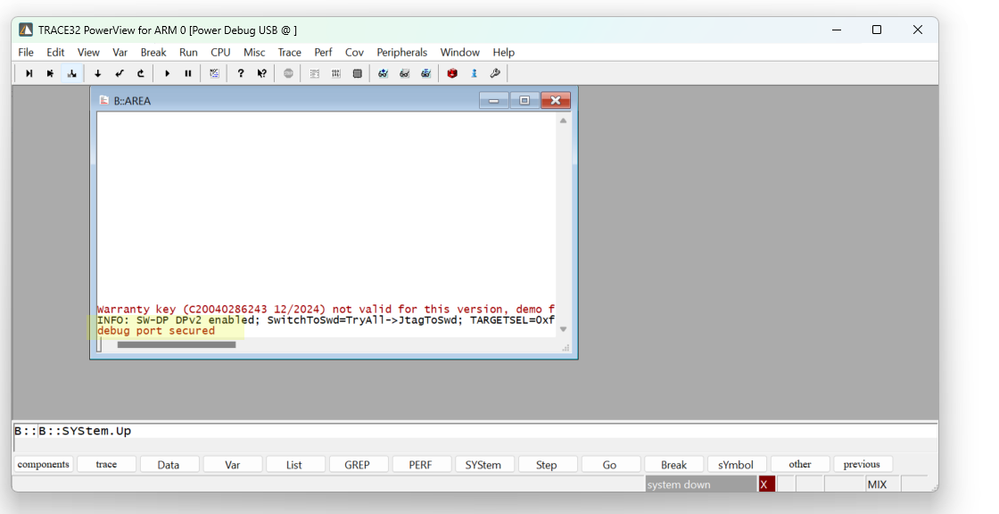

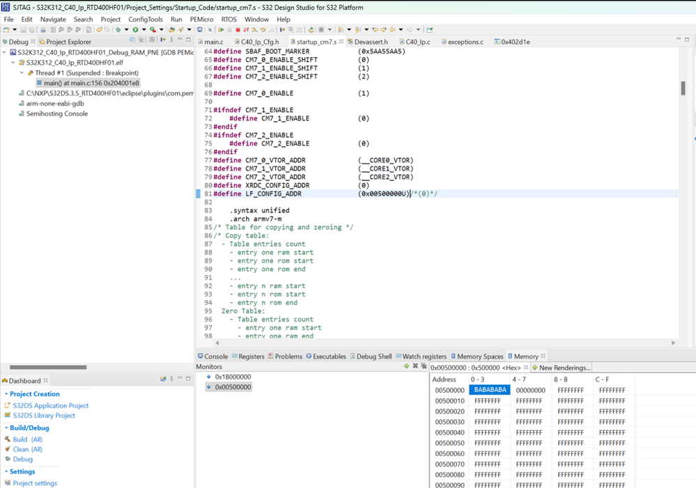

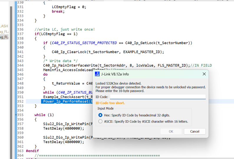

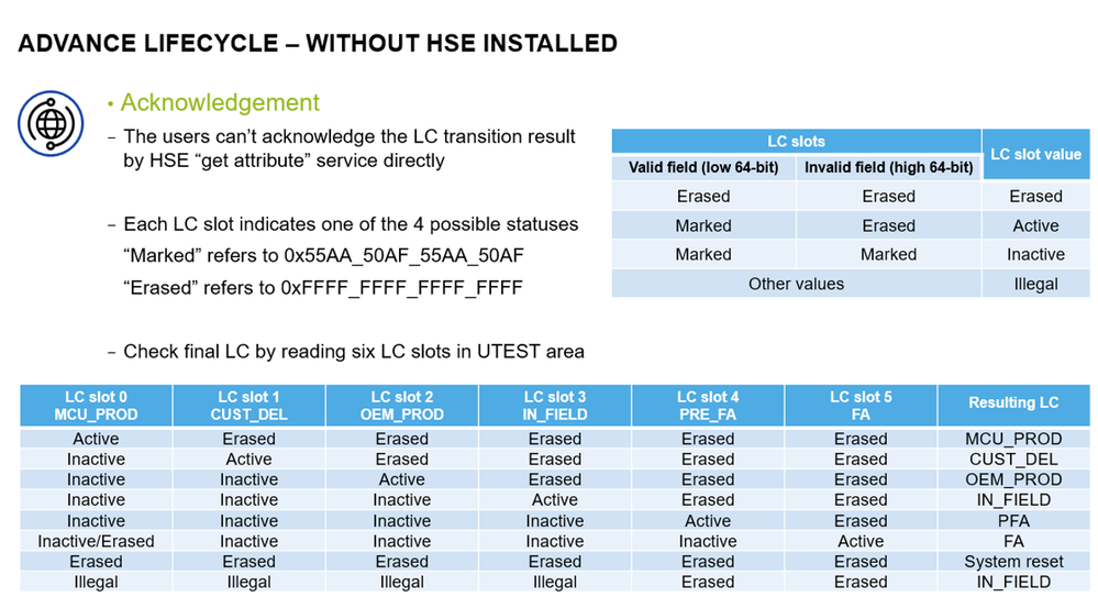

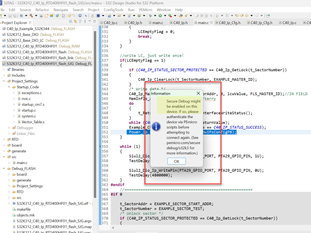

3.3 Program IVT lifecyle related flash area
To really make secure debug work, the lifecycle needs to be evolved to non-CUST_DEL and FA. This article tests the evolution of LC to the IN_FIELD stage:
LCW = 0xDADADADA advances LC to OEM_PROD
LCW = 0xBABABABA advances LC to IN_FIELD
The address corresponding to LC (lifecyle) is the offset 0X24 of IVT, and must be 4-byte aligned. You can specify the address of IVT->LC to a flash area, and then burn the corresponding flash value to the IN_FIELD value: 0xBABABABA
Evolution method:
(1) Set the flash address of IVT LC
(2) Write the IN_FIELD value 0xBABABABA to the corresponding flash address
(3) Software reset
After evolution, you can also check whether the evolution is successful by checking the LC slot combination starting from address 0X1B000220 in the UTEST area. Of course, after the evolution is successful, the debug interface will also be locked, which can be unlocked to view. In addition, you can also view the evolved LC results through the DCM_DCMLCC register.
 Fig 11
Here are the relevant codes:
(1)Project_Settings->Startup_Code->startup_cm7.s
#define LF_CONFIG_ADDR              (0x00500000U)/*(0)*/
.section ".boot_header","ax"
/*00h*/     .long SBAF_BOOT_MARKER /* IVT marker */
/*04h*/     .long (CM7_0_ENABLE << CM7_0_ENABLE_SHIFT) | (CM7_1_ENABLE << CM7_1_ENABLE_SHIFT) | (CM7_2_ENABLE << CM7_2_ENABLE_SHIFT) /* Boot configuration word */
/*08h*/     .long 0 /* Reserved */
/*0Ch*/     .long CM7_0_VTOR_ADDR /* CM7_0 Start address */
/*10h*/     .long 0 /* Reserved */

It can be seen that the flash address specified by IVT offset 0X24 is 0X00500000
(2) Add flash0X00500000 area and write code
#define FLS_SECTOR_ADDR_LC			 (0x00500000U)
#define FLS_SECTOR_ADDR_LC_TEST      (C40_CODE_ARRAY_0_BLOCK_1_S128)
   uint8 lcwValue[8] = {0xBA,0xBA,0xBA,0xBA,0x00,0x00,0x00,0x00};
    t_SectorAddr = FLS_SECTOR_ADDR_LC;
t_SectorNumber = FLS_SECTOR_ADDR_LC_TEST;
    LCEmptyFlag = 1;
    		LCEmptyFlag = 0;
    		break;
    //write LC, just write once!
    if(LCEmptyFlag == 1)
        /* Write data */
    	C40_Ip_MainInterfaceWrite(t_SectorAddr, 8, lcwValue, FLS_MASTER_ID);//IN FIELD
        do
Of course, it should be noted here that if the corresponding flash address has been written with other values, you must first perform an erase operation before writing, or erase the entire chip once before downloading the code.
The test results are as follows:
Before LC evolution:
The 16 bytes of 0X1B000220 are the location of LC slot1. It can be seen that LC slot1 CUST_DEL corresponds to the Active state: that is, the lower 64 bits are Marked, and the upper 64 bytes are Erased
Mared: 0X55AA_50AF_55AA_50AF
Erased: 0XFFFF_FFFF_FFFF_FFFF
The other LC slot2, LC slot3, LC slot4, LC slot5 are all Erased. Figure 8 and Figure 11 can help understand.
 Fig 12
IVT LC  related flash 0X00500000 data result:
 Fig 13
3.4 SW reset
The software reset code is as follows:

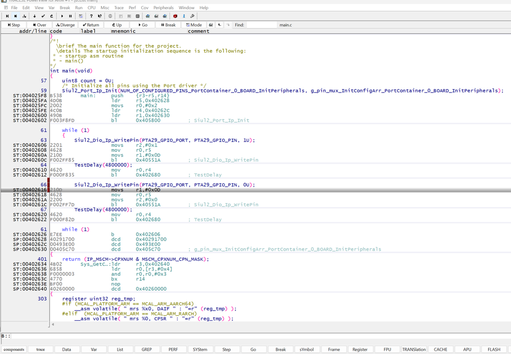

After the software reset, you can see the PE Multilink connection results as follows:
 Fig 14
The results of JLINK locking are as follows:
 Fig 15
The results of the Lauterbach lock are as follows:
 Fig 16

3.2 Lauterbach unlock
Prepare one .cmm file, then change the content to the following content:
Global &SDAP_AUTHSTTS
Global &SDAP_AUTHCTL
Global &SDAP_KEYCHAL_0
Global &SDAP_KEYCHAL_1
Global &SDAP_KEYCHAL_2
Global &SDAP_KEYCHAL_3
Global &SDAP_KEYCHAL_4
Global &SDAP_KEYCHAL_5
Global &SDAP_KEYCHAL_6
Global &SDAP_KEYCHAL_7
GLOBAL &UID0 &UID1
Global &SDAP_AUTHSTTS_Read
GLOBAL &CHAL0 &CHAL1 &CHAL2 &CHAL3 &CHAL4 &CHAL5 &CHAL6 &CHAL7
SYStem.CPU S32K312-M7
sys.mode prepare
&SDAP_BASE_ADDRESS=0x40000700
&SDAP_AUTHSTTS = &SDAP_BASE_ADDRESS
&SDAP_AUTHCTL  = &SDAP_BASE_ADDRESS+0x4
&SDAP_KEYCHAL_0 = &SDAP_BASE_ADDRESS+0x10
&SDAP_KEYCHAL_1 = &SDAP_BASE_ADDRESS+0x14
&SDAP_KEYCHAL_2 = &SDAP_BASE_ADDRESS+0x18
&SDAP_KEYCHAL_3 = &SDAP_BASE_ADDRESS+0x1C
&SDAP_KEYCHAL_4 = &SDAP_BASE_ADDRESS+0x20
&SDAP_KEYCHAL_5 = &SDAP_BASE_ADDRESS+0x24
&SDAP_KEYCHAL_6 = &SDAP_BASE_ADDRESS+0x28
&SDAP_KEYCHAL_7 = &SDAP_BASE_ADDRESS+0x2C
&SDAP_KEYRESP_0 = &SDAP_BASE_ADDRESS+0x40
&SDAP_KEYRESP_1 = &SDAP_BASE_ADDRESS+0x44
&SDAP_KEYRESP_2 = &SDAP_BASE_ADDRESS+0x48
&SDAP_KEYRESP_3 = &SDAP_BASE_ADDRESS+0x4C
&SDAP_KEYRESP_4 = &SDAP_BASE_ADDRESS+0x50
&SDAP_KEYRESP_5 = &SDAP_BASE_ADDRESS+0x54
&SDAP_KEYRESP_6 = &SDAP_BASE_ADDRESS+0x58
&SDAP_KEYRESP_7 = &SDAP_BASE_ADDRESS+0x5C
&SDAP_UID0 = &SDAP_BASE_ADDRESS+0x70
&SDAP_UID1 = &SDAP_BASE_ADDRESS+0x74
&SDAP_DBGENCTRL = &SDAP_BASE_ADDRESS+0x80
&SDAP_SDAAPRSTCTRL = &SDAP_BASE_ADDRESS+0x90
&SDAP_SDAAPGENCTRL0 = &SDAP_BASE_ADDRESS+0xA4
&SDAP_DAP_GEN1_CTRL = &SDAP_BASE_ADDRESS+0xB4
;prepare the key value
;sample adkp_value 5eba18b957523a0c10839b84c481f379
;need byte sway
&arg1 = 0x03020100
&arg2 = 0x07060504
&arg3 = 0x11100908
&arg4 = 0x15141312
&arg5 = 0x00000000
&arg6 = 0x00000000
&arg7 = 0x00000000
&arg8 = 0x00000000
;Enable SDAP Based Debug Authorization
data.set EDBG:&SDAP_SDAAPGENCTRL0 %LE %Long 0x00000001
local &rdata
;&rdata=Data.long(EDBG:&SDAP_AUTHSTTS)&0x00000001
;while &rdata!=0x1
;  &rdata=Data.long(EDBG:&SDAP_AUTHSTTS)&0x00000001
&UID0=Data.long(EDBG:&SDAP_UID0)
&UID1=Data.long(EDBG:&SDAP_UID1)
&CHAL0=Data.long(EDBG:&SDAP_KEYCHAL_0)
&CHAL1=Data.long(EDBG:&SDAP_KEYCHAL_1)
&CHAL2=Data.long(EDBG:&SDAP_KEYCHAL_2)
&CHAL3=Data.long(EDBG:&SDAP_KEYCHAL_3)
&CHAL4=Data.long(EDBG:&SDAP_KEYCHAL_4)
&CHAL5=Data.long(EDBG:&SDAP_KEYCHAL_5)
&CHAL6=Data.long(EDBG:&SDAP_KEYCHAL_6)
&CHAL7=Data.long(EDBG:&SDAP_KEYCHAL_7)
print "UID0 is &UID0"
print "UID1 is &UID1"
data.set EDBG:&SDAP_KEYRESP_0 %LE %Long &arg1
data.set EDBG:&SDAP_KEYRESP_1 %LE %Long &arg2
data.set EDBG:&SDAP_KEYRESP_2 %LE %Long &arg3
data.set EDBG:&SDAP_KEYRESP_3 %LE %Long &arg4
data.set EDBG:&SDAP_KEYRESP_4 %LE %Long &arg5
data.set EDBG:&SDAP_KEYRESP_5 %LE %Long &arg6
data.set EDBG:&SDAP_KEYRESP_6 %LE %Long &arg7
data.set EDBG:&SDAP_KEYRESP_7 %LE %Long &arg8
;Writing SDA AP AUTHCTL.HSEAUTHREQ
data.set EDBG:&SDAP_AUTHCTL %LE %Long 0x00000001
wait 1ms
&SDAP_AUTHSTTS_Read = Data.long(EDBG:&SDAP_AUTHSTTS)
print "SDAP_AUTHSTTS is &SDAP_AUTHSTTS_Read"
local &rdata1
&rdata1 = Data.long(EDBG:&SDAP_AUTHSTTS)&0x60000004
print "rdata1 is &rdata1"
;IF(&SDAP_AUTHSTTS_Read==0x60000005)
IF (&rdata1==0x60000004)
  print "debug function check ok, ready to open"
  ;Writing SDA AP DBGENCTRL.GDBGEN and DBGENCTRL.CDBGEN
  data.set EDBG:&SDAP_DBGENCTRL %LE %Long 0x10000010
ELSE
  PRINT "debug function still closed, please check your security setting and password"
  ENDDO
SYStem.Option TRST OFF
SYStem.Option EnReset OFF
SYStem.Option DUALPORT ON
; system.config debugporttype swd
SYSTEM.JTAGclock 10Mhz
SYSTEM.Attach
print "debugger attached, but No flash driver"
break
ENDDO
&arg1 to &arg8 fill in the real used key。
After saving, run the script using Lauderbach trace32, the results are as follows:
 Fig 19
 Fig 20
 Fig 21
As you can see, Lauderbach can be unlocked and mounted, and can directly enter debug mode after downloading new code.
3.3 Segger JLINK unlock
From the current situation, Segger JLINK's non-HSE static unlocking is relatively convenient, because the latest Segger driver has added this function by default, which can directly identify whether it is locked, and then ask for the key value to be entered, and it can be automatically unlocked after entering. The driver version supported by the test is: JLink_V812a, open the JLINK commander, and do the connection action:
 Fig 22
 Fig 23
As you can see, JLINK has been unlocked successfully.
Of course, some lower-version drivers do not have this automatic lock recognition and require key input. In this case, you can unlock it by directly controlling the SDA_AP register.
The following is my actual command line operation method and results, for reference only:

J-Link>connect
Device "S32K312" selected.
Connecting to target via SWD
ConfigTargetSettings() start
ConfigTargetSettings() end - Took 12us
InitTarget() start
SDA_AP detected
Unlocking device if necessary...
  Device is not locked. Proceeding without the unlock procedure.
Checking if debug access is already enabled...
  Debug access is not enabled yet. Performing enable debug access sequence...
  Debug access enabled
Checking if HSE firmware is installed...
  HSE firmware not installed
Checking if Cortex-M7_0 and Cortex-M7_1 are operating in lockstep mode
  Lock step mode disabled or not available
InitTarget() end - Took 16.5ms
Found SW-DP with ID 0x6BA02477
DPIDR: 0x6BA02477
CoreSight SoC-400 or earlier
AP map detection skipped. Manually configured AP map found.
AP[0]: MEM-AP (IDR: Not set, ADDR: 0x00000000)
AP[1]: APB-AP (IDR: Not set, ADDR: 0x00000000)
AP[2]: MEM-AP (IDR: Not set, ADDR: 0x00000000)
AP[3]: AHB-AP (IDR: Not set, ADDR: 0x00000000)
AP[4]: AHB-AP (IDR: Not set, ADDR: 0x00000000)
AP[5]: AHB-AP (IDR: Not set, ADDR: 0x00000000)
AP[6]: MEM-AP (IDR: Not set, ADDR: 0x00000000)
AP[7]: MEM-AP (IDR: Not set, ADDR: 0x00000000)
AP[4]: Skipped ROMBASE read. CoreBaseAddr manually set by user
AP[4]: Core found
CPUID register: 0x411FC272. Implementer code: 0x41 (ARM)
Cache: L1 I/D-cache present
Found Cortex-M7 r1p2, Little endian.
FPUnit: 8 code (BP) slots and 0 literal slots
ROM table scan skipped. CoreBaseAddr manually set by user: 0x40250400
I-Cache L1: 8 KB, 128 Sets, 32 Bytes/Line, 2-Way
D-Cache L1: 8 KB, 64 Sets, 32 Bytes/Line, 4-Way
SetupTarget() start
Initializing ECC RAM...
  RAMCodeAddr: 0x20000000
  RAMInitAddr: 0x20000010
  RAMInitSize: 0x00007FF0
  InitPattern: 0xDEADBEEF
  ECC RAM initialized successfully
  RAMInitAddr: 0x20400000
  RAMInitSize: 0x00004000
SetupTarget() end - Took 12.0ms
Memory zones:
  Zone: "Default" Description: Default access mode
Cortex-M7 identified.
J-Link>

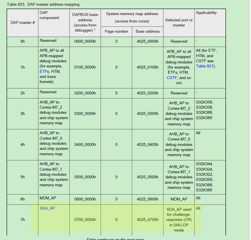

It should be noted here that for SDA_AP control, the addresses of the kernel and DAPBUS control are different, which is why the above command line controls the address starting from 0x07000000. It can be seen that the above command line method finally successfully injected the key and unlocked it successfully.

3.4 LC test result after unlock debug
After unlocking, check the UTEST and DCM register values ​​of LC as follows:
Fig 25
Fig 26
As you can see, it is already in IN_FIELD. The values ​​in the UTEST area also meet the following conditions:
LC slot1 is Inactive,
LC slot2 is Inactive,
LC slot3 is Active,
LC slot4 is Erased,
LC slot5 is Erased,

When doing this set of functions, I also encountered many pitfalls, which are summarized here.
5.1 Trap1:RTD400/500 flash operation copies to RAM
  When a DFAE first reported this problem, I was still suspecting because after I copied the C40 code to RAM, I could still operate the flash successfully. But later I found that if I changed the erase area to block0, that is, when it was in the same block as the code, although the C40 code was copied to RAM successfully, and the map file was also in the ramcode area, when running it, it would go into hardfault and the error reported was still RWW error:
Fig 27
After many tests and final summary, we got the conclusion of Chapter 3.1. In fact, the code for processing C40 and OSIF was called without completing the flash operation, which led to the RWW problem. Therefore, after doing flash busy waiting or putting OSIF into RAM, the final test verification was successful.
5.2 Trap 2: Failure to push LC
    After completing the key burning, the test of the flash value IN_FIELD of the LC area specified by IVT was OK, and then reset, even power on again, it can still enter the debug mode smoothly. This situation means that the secure debug is not successful at all. I was stuck at this point for eve one day, looking at the principles, registers, and memory. Finally, I was helpless and went back to the .s file to check the position of IVT. Only then did I find that the IVT and LC position of RTD400 were wrong, and it was actually written to the offset 0X28. After the modification, it was successful, and the emulator reminded that debug had been locked. This point of RTD500 has been fixed.
Fig 28
5.3 Trap 3: Lauterbach unlocking script fails to unlock
This problem is also quite strange, because the same Lauterbach script was successfully unlocked by my colleagues and customers before, but it just couldn't be unlocked when I did it, and it was always locked. Later, After debug the Lauterbach script , we found that there were two points that were stuck, both about challenge is ready, but my chip was not challenge ready. Because this kind of static encryption does not need challenge at all, just take care of the response, so I skipped the challenge check directly later, such as blocking the following code:
while &rdata!=0x1
Modify the script:
IF (&SDAP_AUTHSTTS_Read==0x60000005)
To:
That is, the status register does not identify the challenge, and then unlock is working.

For the RTD500 C40 FLASH operation linker method, as RTD500 flash driver also calls the SchM_Mem_43_INFLS related driver, so in the linker file, also need to put the SchM_Mem_43_INFLS.o to RAM.
The related linker file is:
Modify C40_Ip_Example_S32K344 Project_Settings->Linker_Files->Linker_flash_s32k344.ld
.pflash :
        KEEP(*(.boot_header))
        . = ALIGN(8192);  /* The minimum erase size of C40 Flash IP is 8kb */
        __text_start = .;
        __interrupts_init_start = .;
        KEEP(*(.intc_vector))
        . = ALIGN(4);
        __interrupts_init_end = .;
        KEEP(*(.core_loop))
        . = ALIGN(4);
        *(.startup)
        . = ALIGN(4);
        *(.systeminit)
        . = ALIGN(4);
        *(.text.startup)
        . = ALIGN(4);
        *(EXCLUDE_FILE (*C40_Ip.o *OsIf_Timer.o *OsIf_Timer_System.o *SchM_Mem_43_INFLS.o) .text)
        *(EXCLUDE_FILE (*C40_Ip.o *OsIf_Timer.o *OsIf_Timer_System.o *SchM_Mem_43_INFLS.o) .text*)
        . = ALIGN(4);
        *(EXCLUDE_FILE (*C40_Ip.o *OsIf_Timer.o *OsIf_Timer_System.o *SchM_Mem_43_INFLS.o) .mcal_text)
        . = ALIGN(4);
        . = ALIGN(4);
        *(.acmcu_code_rom)
        . = ALIGN(4);
        __acfls_code_rom_start = .;
        *(.acfls_code_rom)
        . = ALIGN(4);
        __acfls_code_rom_end = .;
        __acmem_43_infls_code_rom_start = .;
        *(.acmem_43_infls_code_rom)
        . = ALIGN(4);
        __acmem_43_infls_code_rom_end = .;
        KEEP(*(.init))
        . = ALIGN(4);
        KEEP(*(.fini))
        . = ALIGN(4);
        *(.rodata)
        *(.rodata*)
        . = ALIGN(4);
        *(.mcal_const_cfg)
        . = ALIGN(4);
        *(.mcal_const)
        . = ALIGN(4);
        __init_table = .;
        KEEP(*(.init_table))
        . = ALIGN(4);
        __zero_table = .;
        KEEP(*(.zero_table))
    } > int_pflash
   .itcm_text : AT(__tcm_code_rom_start)
        . = ALIGN(4);
        __itcm_start__ = .;
        *(.itcm_text*)
        . = ALIGN(4);
        KEEP(*C40_Ip.o (.mcal_text*))
        KEEP(*C40_Ip.o (.text*))
        KEEP(*C40_Ip.o (.text))
        KEEP(*OsIf_Timer.o (.mcal_text*))
        KEEP(*OsIf_Timer.o (.text*))
        KEEP(*OsIf_Timer.o (.text))
        KEEP(*OsIf_Timer_System.o (.mcal_text*))
        KEEP(*OsIf_Timer_System.o (.text*))
        KEEP(*OsIf_Timer_System.o (.text))
        KEEP(**SchM_Mem_43_INFLS.o (.mcal_text*))
        KEEP(**SchM_Mem_43_INFLS.o (.text*))
        KEEP(**SchM_Mem_43_INFLS.o (.text))
        . = ALIGN(4);
        __itcm_end__ = .;
    } > int_itcm
Modify C40_Ip_Example_S32K344 main.c
#define EXAMPLE_SECTOR_START_ADDR (0x004FE000)//(0x00600000U)
#define EXAMPLE_SECTOR_TEST (C40_CODE_ARRAY_0_BLOCK_0_S127)//(C40_CODE_ARRAY_0_BLOCK_2_S256)
Others no modification, test result:
