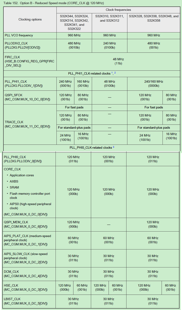

2.1.4 option B Recommended Solution
In this article, K312 will configure the clock of option B in EB.
Fig 7

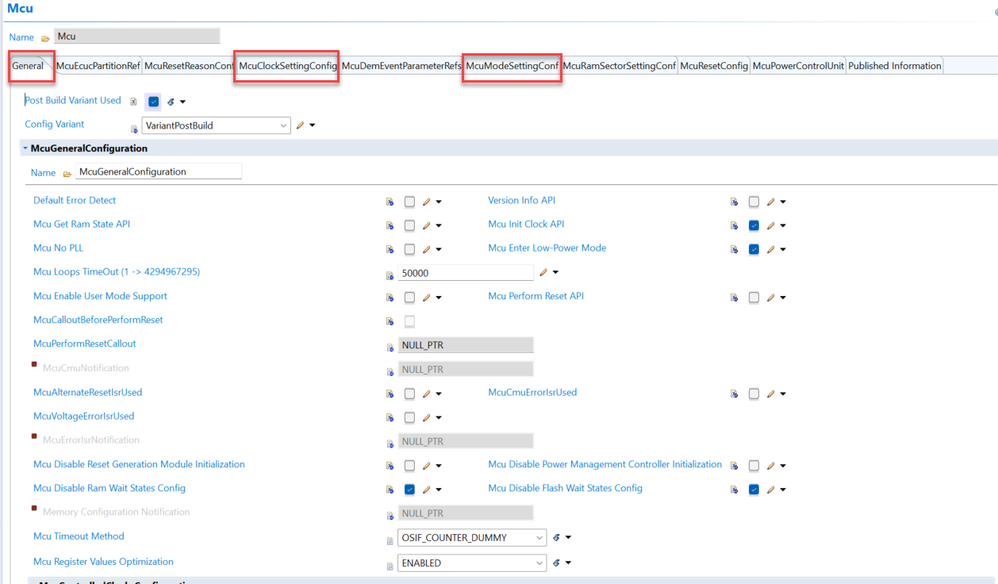

The following figure is an overview of the MCU. The main configured modules have the following three components:
General, McuClockSettingConfig, McuModeSettingConf
Fig 8
2.2.1 General configuration
In addition to Figure 8, you need to turn on the internal and external fast and slow clock control and PLL control, and add the corresponding API, as well as the crystal oscillator frequency. If this is not turned on, the corresponding configuration later will not be able to be configured.
Fig 9

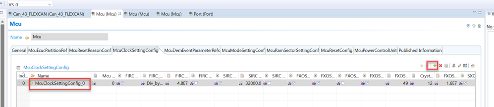

First, you need to add a clock configuration:
Fig 10

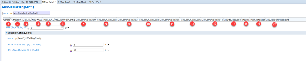

Click in and there will be detailed configuration:
Fig 11
There are 17 items in total. You can keep the default configuration for options 1 and 6. Since the board does not connect to the external slow crystal oscillator 5, it is not configured. The rest should be configured according to the actual situation. The following explains them one by one:

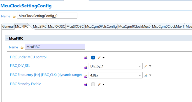

2.2.2.1 McuFIRC configuration
   Internal fast clock, 48MHz:
Fig 12

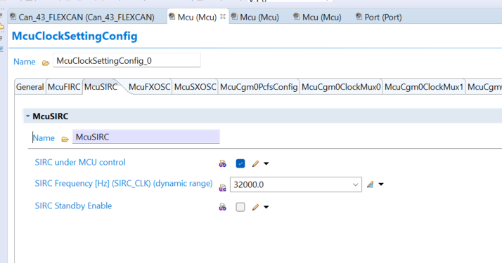

2.2.2.2 McuSIRC configuration
Internal slow clock 32Khz
Fig 13

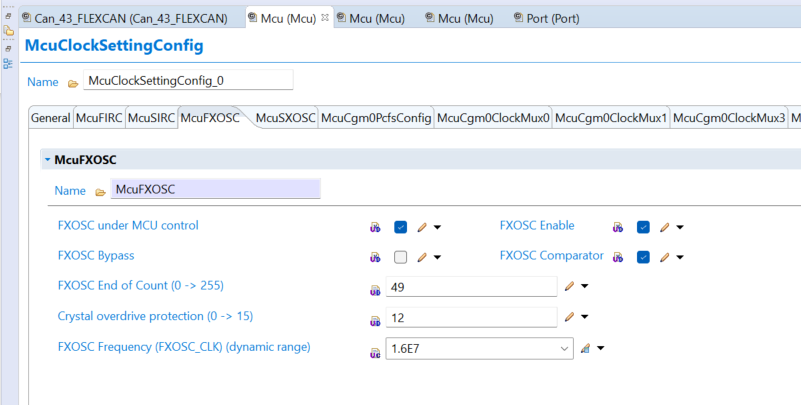

2.2.2.3 McuFXOSC configuration
External crystal oscillator 16MHZ, fill in according to the actual connection situation.

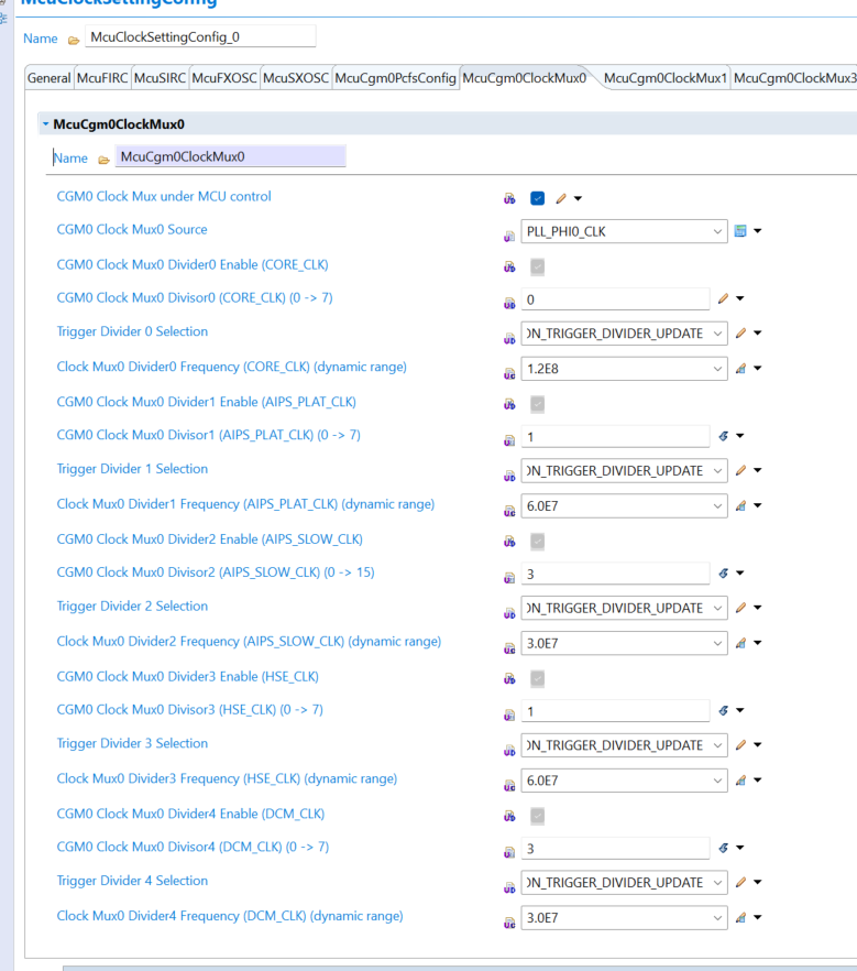

2.2.2.4 McuCgm0ClockMux0 configuration
Mux0 configuration, here are configured core clock, AIPS_PLAT_CLK, AIPS_SLOW_CLK, HSE, DCM_CLK, is to meet the optionB requirements, and the clock comes from PLL_PHI0_CLK. When actually configuring, first configure the PLL clock to output the correct PLL_PHI0_CLK, PLL_PHI1_CLK clock.

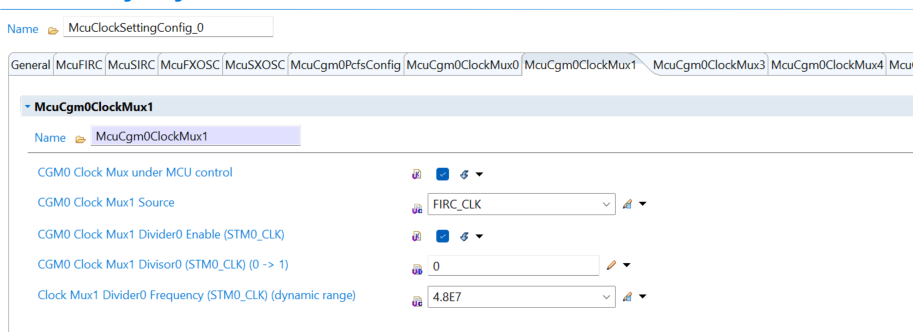

2.2.2.5 McuCgm0ClockMux1 configuration
Fig 16
It can be configured according to the clock source required by the actual module.

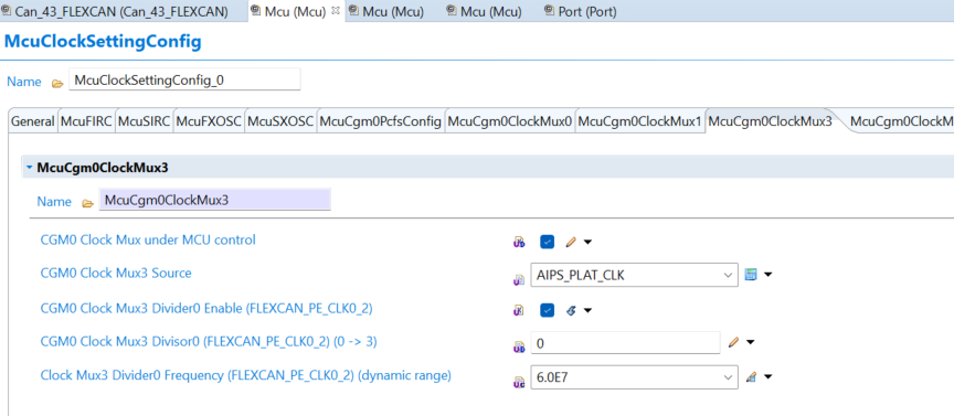

2.2.2.6 McuCgm0ClockMux3 configuration
Configure the clock source of the FLEXCAN0-2 module:
Fig 17

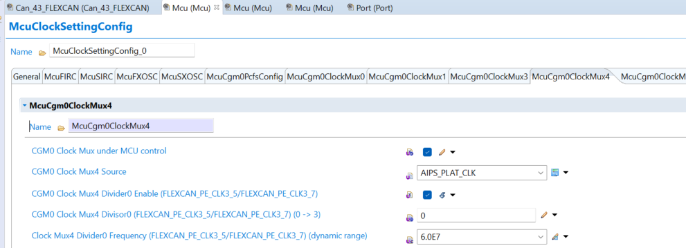

2.2.2.7 McuCgm0ClockMux4 configuration
Configure the clock source of the FLEXCAN3-5 module:
Fig 18

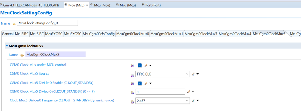

2.2.2.8 McuCgm0ClockMux5 configuration
Configure the clock source of the CLKOUT_STANBY module:
Fig 19

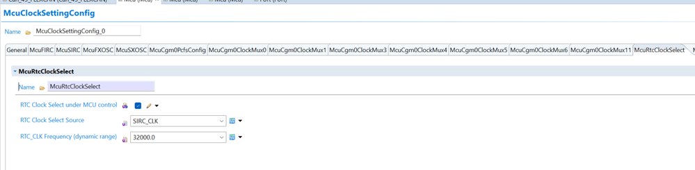

2.2.2.11 McuRtcClockSelect configuration
Configure the clock source of the RTC module
Fig 22

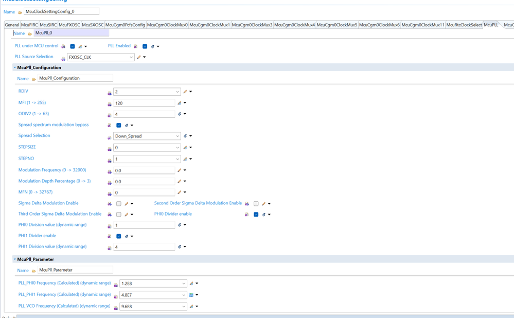

2.2.2.12 McuPLL configuration
Configure the clock source of the PLL module
Fig 23

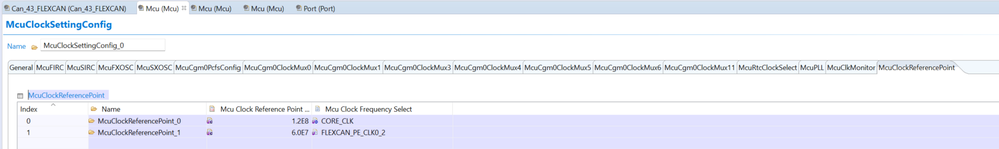

2.2.2.13 McuClockReferencePoint configuration
Configure the reference clock and the clock source selection interface of the peripheral modules.
Fig 24
At this point, the clock configuration is complete.

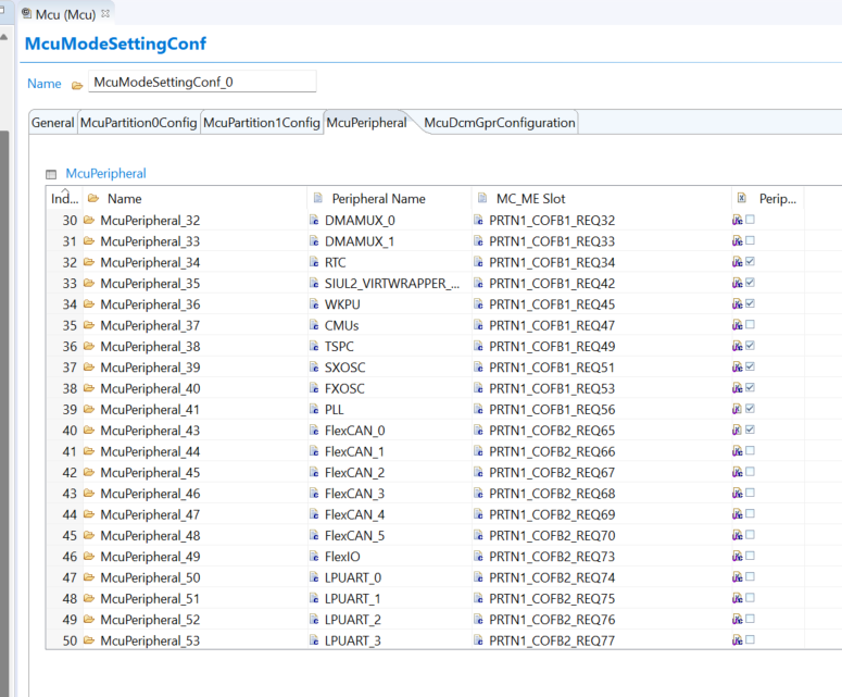

2.2.3 McuModeSettingConf  configuration
In Mcu's McuModeSettingConf->McuPeripheral, you need to turn on the peripherals you want to use:
Fig 25

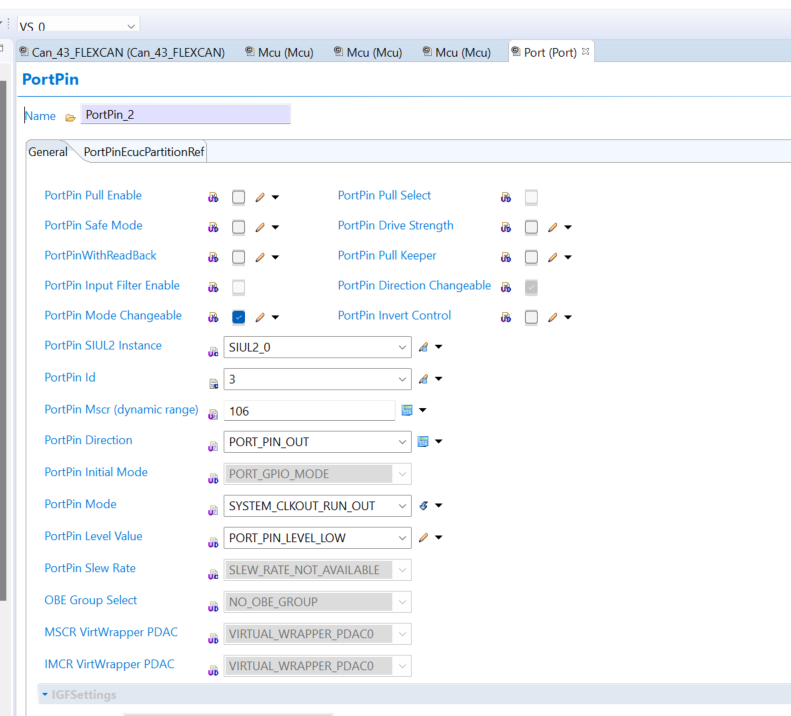

2.2.4 PORT  configuration
Because the internal clock needs to be output to CLKOUT_RUN, K312's PTD10 MSCR106 is checked, so the PORT pin is added as follows:
Fig 26

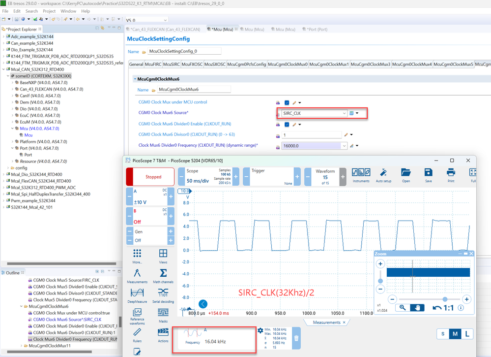

3.2 CLKOUT SIRC_CLK DIV2
Fig 29
It can be seen that the original 32Khz clock of SIRC is divided by 2 and the clock waveform of 16khz is obtained, which is correct!

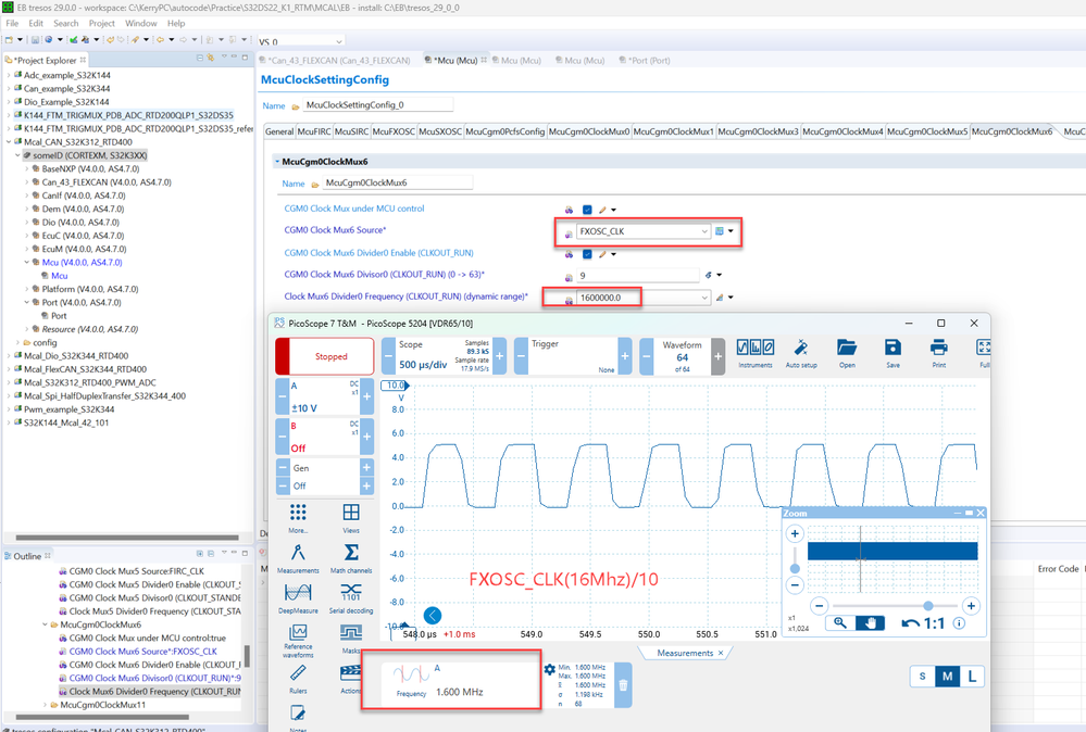

3.3 CLKOUT FXOSC_CLK DIV10
Fig 30
It can be seen that the original 16Mhz clock of FXOSC is divided by 10 and the clock waveform of 1.6Mhz is obtained.

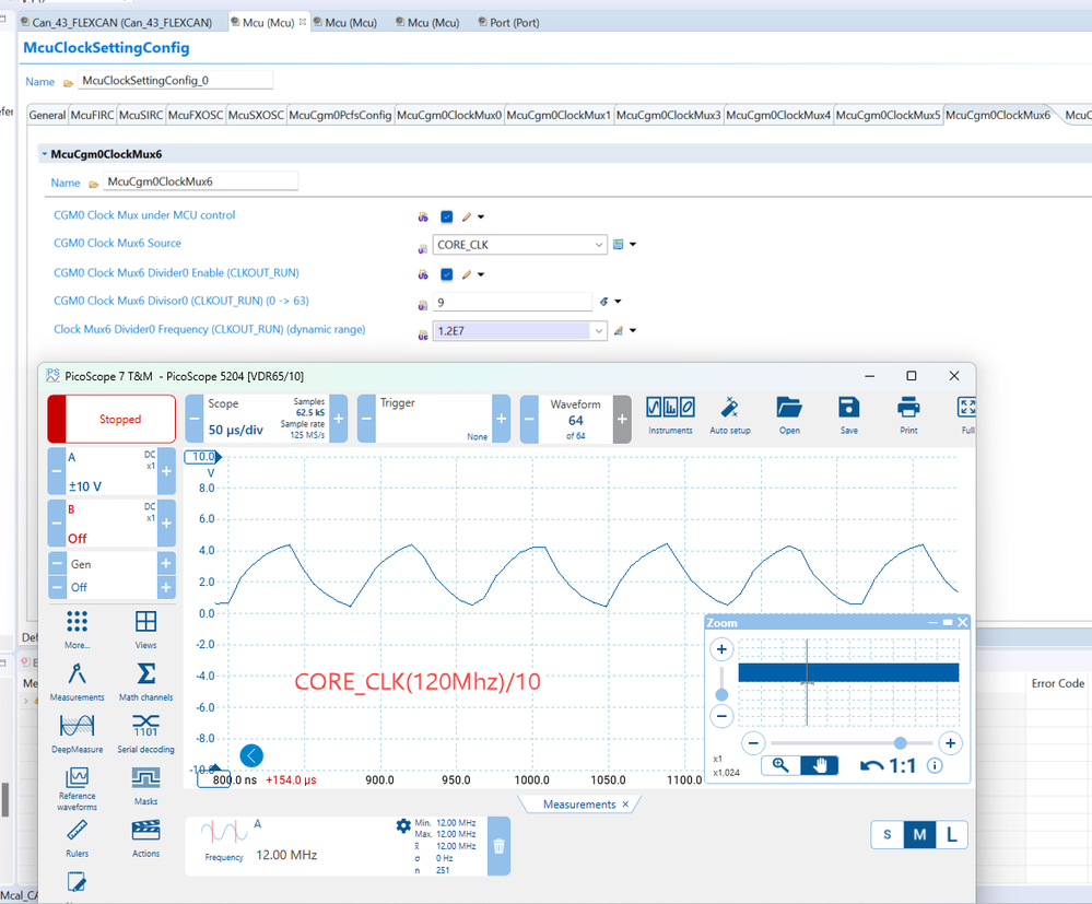

3.5 CLKOUT CORE CLK DIV10
Fig 32
It can be seen that the original 120Mhz clock of CORE is divided by 10 and the 12Mhz clock waveform is obtained, which is correct.

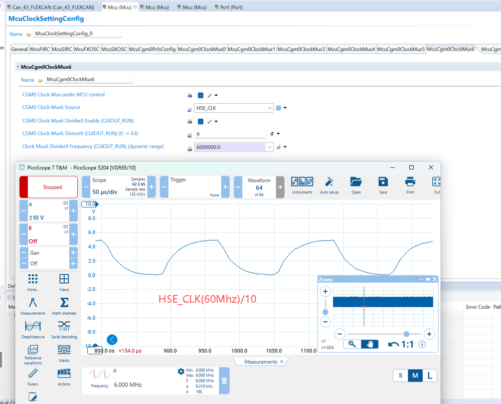

3.7 CLKOUT HSE CLK DIV10
Fig 34
It can be seen that the original 60Mhz clock of HSE is divided by 10 and the clock waveform of 6Mhz is obtained, which is correct.

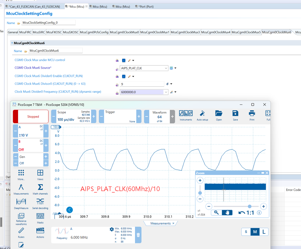

3.8 CLKOUT AIPS_PLAT CLK DIV10
Fig 35
It can be seen that the original 60Mhz clock of AIPS_PLAT_CLK is divided by 10 and the clock waveform of 6Mhz is obtained, which is correct.
