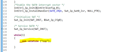

 The purpose of this demo application is to present a usage of the
 SWT IP Driver for the S32K3xx MCU.
* Test HW: S32K3X2EVB-Q172
* MCU: S32K312
* Compiler: S32DS3.5
* SDK release: RTD 3.0.0
* Debugger: PE micro
* Target: internal_FLASH
With S32K312 device take care, HSE clock AIPS_SLOW_CLOCK ratio,  kept 1:2 :--
The example we use to trigger the SWT once & go to while(1) loop.
This will trigger the watchdog RESET.

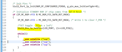

Then After RESET from SWT we will check at starting of main function, if RESET reason is SWT, then glow LED and wait in while(1) loop  :--
