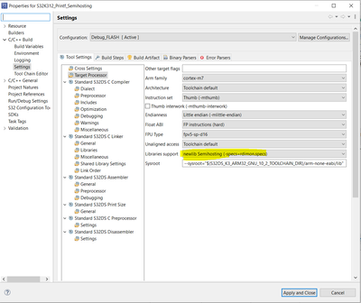

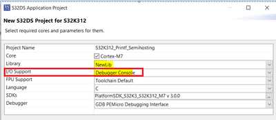

Create New project :--
Select Semi hosting library in project Properties :--

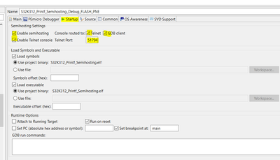

In Debugger setting :---

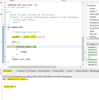

Include file :--
#include <stdio.h>
Output :--

Hi @Dinesh_Guleria ,
Thanks for the information. It works but only with debugger.
I cannot run the code without debugger with given settings.
It runs without debugger when I select "libraries support" as non semihosting options like  newlib or newlib nano.
What could you suggest?
