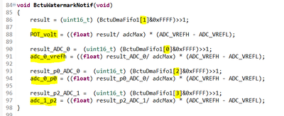

 Converted results from BCTU FIFO are moved by DMA into result array.
 ADC channel S10 is connected to board's potentiometer.

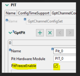

Set PIT Freeze Enable :---

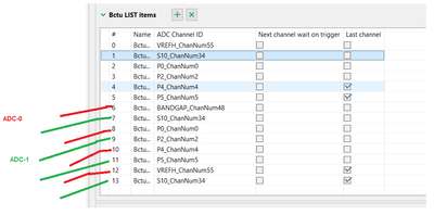

BCTU will be do the parallel conversion for channel mentioned in BCTU list :--
"NEW DATA DMA enable mask" :--
controls These bit field in MCR register
"ADC target mask" :--
It controls "ADC_SEL " bit field in "Trigger Configuration (TRGCFG_0 - TRGCFG_71)"
for single conversions you can enable only one instance
so the possible values for target mask:
1 (0b001) ADC0
2 (0b010) ADC1
3 (0b100) ADC2|

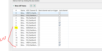

for list of conversions we can enable also parallel con version
for example
3 (0b011) parallel conversion of ADC0 and ADC1
The trigger is configured as a list of parallel conversions ADC0, ADC1 in “Adc Target Mask”.
List of ADC channels is defined in “BCTU List Items” while order is given by the “Adc Target Mask”: BctuListItems_0 is ADC0, BctuListItems_1 is ADC1 etc.

I connected VDD from board on adc_0_p0 (PTD1 : J412-1)  and adc_1_p2 (PTE0 J412-13).
Also POT value on S10 of ADC-1 & ADC-0-VREFH value coming correct & STABLE.

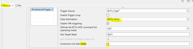

=========================Using  FIFO-2 =================
FIFO-2 Trigger & LIST Index :--
ADC channel conversion :--
