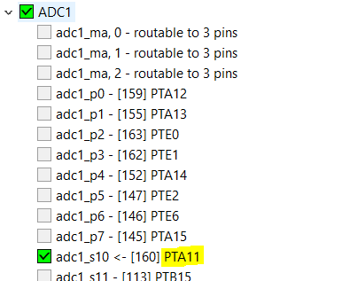

 The example uses the PIT0 trigger to trigger  conversions on ADC1.  ADC channels
 are selected to be converted on  ADC-1:
 ADC channel S10 is connected to board's potentiometer.
#define ADC_SAR_USED_CH_BANDGAP 48U /* Internal Bandgap Channel */
#define ADC_SAR_USED_CH_POT_0 34U
