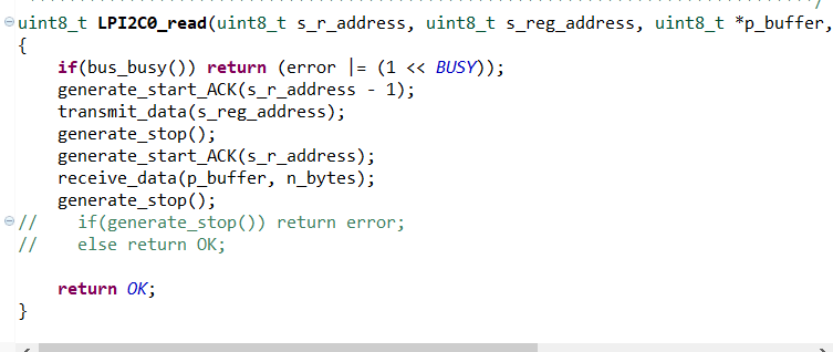

I am using this code for i2c protocol between s32k144(master) and lidar lite v3(slave). I have configured the addresses and registers properly. I am receiving distance values , however I have to reboot the sensor to get new values. I tested the sensor with other boards , it works fine. This sensor does not support repeated start hence I have edited the read and write accordingly.
I am attaching my modified code below. Could you tell me what could be my mistake?
Any help appreciated!!

Hello Arjun,
Can you please scope the bus and compare it with the specified lidar lite v3 I2C protocol?
Do you see any error flags?
BR, Daniel
