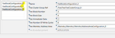

Driver configuration :--
Three FEE blocks are created.
Each FEE block can be considered as EEPROM variables
How customer can use FEE block as EEPROM variable.

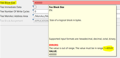

Max size of FEE block :--

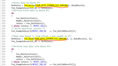

You can declare a MACRO for the Variable of EEPROM :--
FOUR_BYTE_EEPROM_FEE_VARIABLE
How to Read and write the FEE variables :--

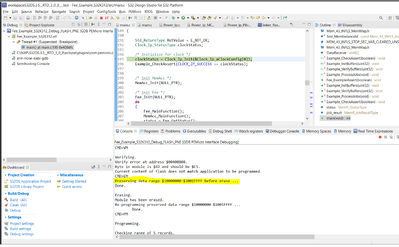

Pe Micro use to delete the Dataflash, on every new FLashing of firmware, which corrupts the EEPROM data.
After making this changes in debug configuration it worked..
