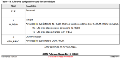

In the S32G2 RM, there is "life cycle". What's the full meaning of life cycle, and how should we use it?
844 Views
Daniel-Aguirre
The "life cycle" under the S32G2 RM refers to the stage of the application being developed. As seen in the S32G2 RM [Page 1142, S32G2 Reference Manual, Rev. 6, 11/2022]:
"Life cycle state (blocks some boot modes that are valid only for specific life cycle states)"
Also:
Which provides the SW state of development to the platform.

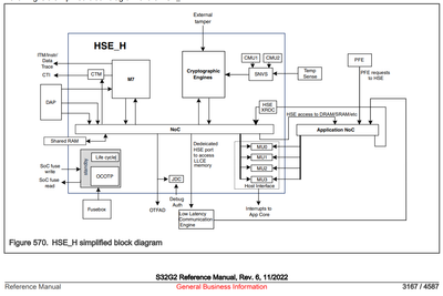

At the end, this feature should be related to the HSE_H:
If more information is required, HSE is under NDA and confidential, for which we recommend sending this inquiry to your local NXP representative/FAE to start the process on this topic.
