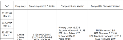

Dear NXP fellows:
I'm currently developing Ethernet related functions and I'm looking at "S32G3_LinuxBSP_42.0_Release_Notes.pdf", The firmware specified by pfe is version 1.8.
But after I burned fsl-image-auto-s32g399ardb3.sdcard into the sd card, I saw that there was already a pfe firmware, so do I need to manually replace the pfe firmware from the official website with the one in the bsp?
root@s32g399ardb3:~# ls /lib/firmware/
s32g_pfe_class.fw  s32g_pfe_util.fw  sja1110_uc.bin

Hi, @jiajun_cheng
Thanks for your post.
The FW you found from the pre-built images could be the same version shown in the release notes, you may not need to manually update the PFE FW if using the default image.
Chenyin
