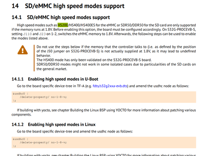

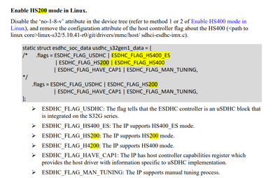

May I ask how to configure HS200 on s32G linux? Under uboot, it can be done by modifying Kconfig, but I couldn't find a place to configure it on linux?

The rdb3 board I'm using is currently based on BSP34 and I plan to upgrade to bsp39. However, I haven't found a way to configure hs200 under either version of linux. The default is hs400es.

You can refer to the AN13667(AN13667: eMMC Enablement and Debugging Tips Application Note) and S32G2_LinuxBSP_41.0_User_Manual.pdf to find some information about using HS200 in Linux.
Hope it can help you.
