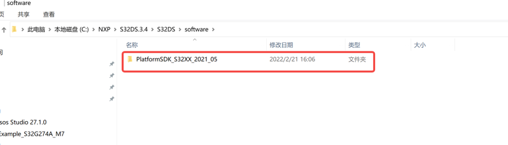

hi, nxp, how to get the example projects based on lwip and freeRTOS ?
The RTD package has been installed, but i can not find the lwip or freeRTOS example projects.
If I want to create new project based on lwip or freeRTOS or some other SDK , which package should I install ?

nioer
hi, NXP, we could not find the example from the package of LWIP or FreeRTOS on S32G2.
could you give us some links or package links?
Thanks .

nioer
We don't know how to download the related software package of LWIP or FreeRTOS.
A lot of package of S32DS was installed, but still can not find the related demo of LWIP or FreeRTOS.
Could you please provide us some clue how to download the related demo or packages of LWIP and FreeRTOS ?
Thank you very much .

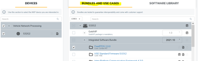

bpe
You have to install the following packages: Real Time Drivers, FreeRTOS, TCP/IP stack, in that order.
Use online Automotive Software Package Manager and download all mentioned above packages in a bundle to ensure version compatibility:
Study the documentation enclosed with the bundle and each package Release Notes for installation steps.

nioer
hi, we could not find the Install both FreeRTOS and TCP/IP packages, what is the package number?
v3.4.1? or other? Could you give us a link to download the packages?
