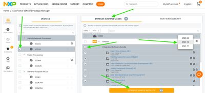

You can also try any version of a software bundle offered in AUTO-SW-PACKAGE-MANAGER, the version in a bundle were testes together :
To avoid having too many problems, you can have a second installation of S32DS with different software versions, this is to avoid loosing your current setup in case the problem persists.
