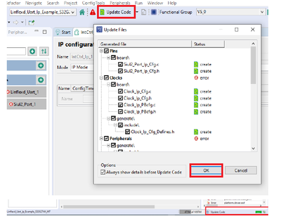

Then you can try again, don't forget to click "update code".

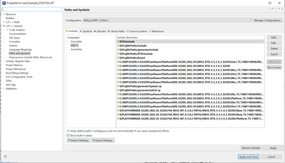

2.fix compiler issue like [!IF "var:defined('postBuildVariant')"!] or [!CODE!][!// issue by "click update code" under Configtools item.

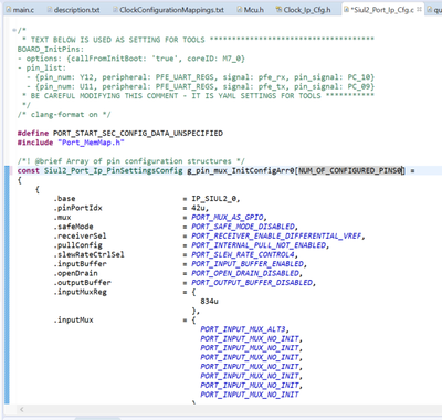

3. fix code generate error for "NUM_OF_CONFIGURED_PINS0" as in header file it is NUM_OF_CONFIGURED_PINS.
