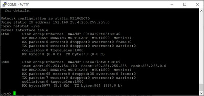

I follow the steps of "HOWTO: Program Serial RCON using S32 Debug Probe S32G2xx" and meet some errors (whole cmd log in attachment). The connection to S32 debug probe seems OK in ccs.exe console (shown as picture below)
I have tried both static and dynamic IP address with telnet CORE console, but same errors came out.
Any solution to the errors?

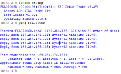

This is a probe connectivity error. Typically it is resolved when you specify the
correct IP address of the probe. Connect a terminal to the probe and issue netstat -ive
command to see assigned IP addresses:
Note that there are separate IP addresses for
USB and for Ethernet connections and that only the IP assigned to the Ethernet
connection can be set statically. The IP of the USB connection is always
dynamic and it is essential that you read it and copy to the Python script
before you run it. If your S32 Debug Probe is connected via Ethernet, make sure
there is no firewall.
