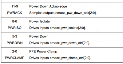

From the RM of s32g2, it seems the port of pfe can be power down by software. Is this true? The power rail of every port can be shut off in the chip while the whole chip is still power on?

The RM document does describe that pfe ports can be Power Down by software control, and the ability to independently control the power status  is an important  feature.
