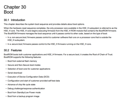

 For more information about the booting flow you can check Chapter 30 of the reference manual [page 1225, S32G2 Reference Manual, Rev. 8, February 2024]:

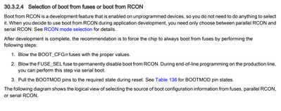

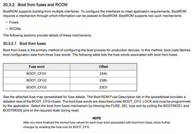

In particular please check sections 30.3.2 Boot from fuses and RCON,30.3.2.1 Boot from fuses and 30.3.2.4 Selection of boot from fuses or boot from RCON [pages 1227 and 1228]:

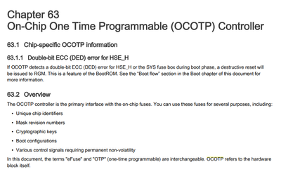

Please also check Chapter 63 On-Chip One Time Programmable (OCOTP) Controller [page 3358]:
For an example program you can check Ocotp_Ip_Example_S32G274A_M7 or Ocotp_Example_S32G274A_M7, for the RTD or MCAL/AUTOSAR API respectively. Please be careful when executing the code, as you know the fuses are one time programable.
