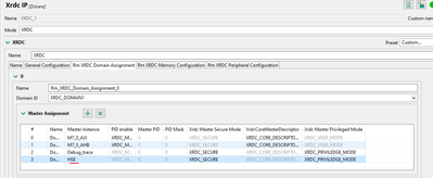

I use M7_0 XRDC example and adding a slot is "XRDC_LINFLEX0" in peripheral configure list.
If running the code, xrdc_Ip_Init() with debug probe will get "core disabled", then get stuck.
How to use LinFlex0 in XRDC? Is that can't add single in peripheral list?

We have received information which confirms our suspicions over BootROM being the problem. If you need to use LINFlex0 instance, you need to also add "HSE" into the "Master Assignment" as shown below:
After this, you should be able to continue the execution of the application. We have confirmed from our side that after stepping from Xrdc_init() we can continue debugging the application.

LanceYu
Thanks for your support, it is successful xrdc_init() by your suggestion.
