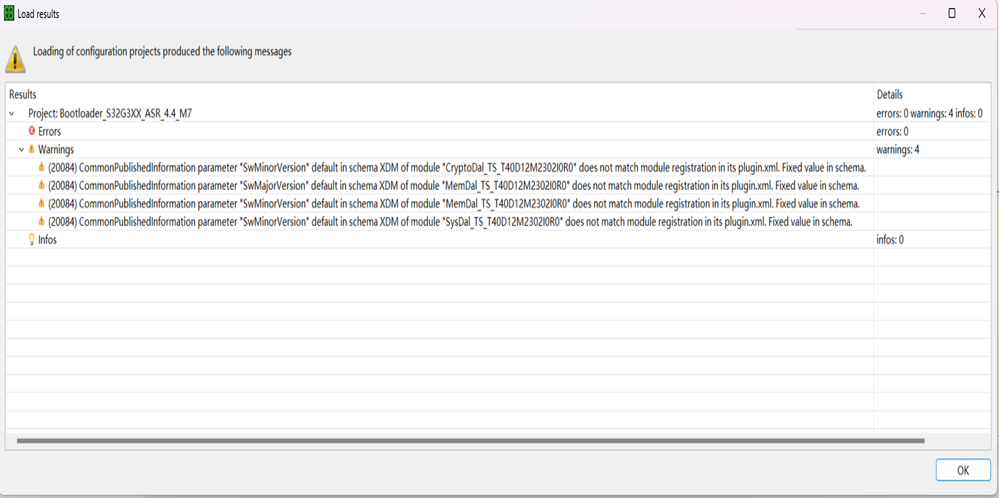

Hello, I imported bootloader project (Integration_Reference_Examples_S32G3_2023_02), and got warning messages after loading configurations,
Thanks firstly
1 解答
2,270 次查看
Daniel-Aguirre
For our setup, we are seeing the same messages you are seeing:
Still, we can compile and run the bootloader no problem. We are not seeing any problem by ignoring these messages.
Please, let us know.

Thats mean that the T40012 is not matched with your current design, you have to checked this on swMinor and Mayor version, if you don't have the T40012 that you can avoid this warning.

About this topic I want to know what it will impact if I ignored warning message even though it did not block compilation.
