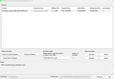

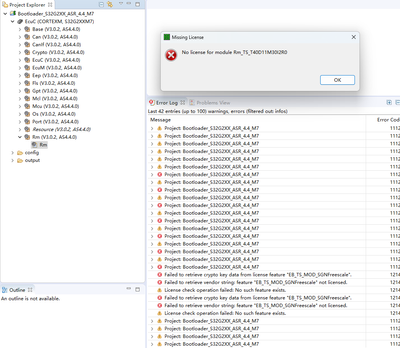

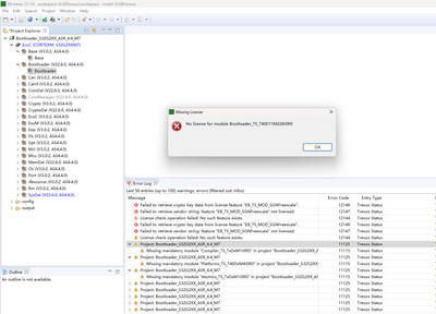

When I use the "EB" tool to refer to "AN13750" to configure "Bootloader_S32G2XX_aSR_4.4_S7", the following error occurs and it prompts that there is no license. How can I solve it?At the same time, I have successfully imported 'SW32G-RTD-4.4_3.0.2.HF01. link' into EB

From the logs shared, seems the license is not well detected by the EB, I suggest reinstalling both EB and corresponding license administrator(removing all EB related packages first, and then reinstall 27.1 and corresponding license administrator software), furthermore, would you mind also sharing the downloading page for EB in your account? (just mask the license number)

I tried downloading version 27.1.0, but still have the same problem. It seems to be a license issue and some modules are missing. Is there any other solution?

The activation status is shown in the following figure:
