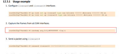

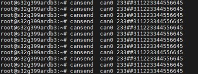

I am using S32G3 board doing the CAN message testing.
after the config, I can use cansend command send the  CAN messages.
And i want to receive CAN message from the PC.
Does the BSP has receive command of CAN message?

Hi,Wzlinux
Thank you for contacting us.
Do you want to test receive command in the BSP? You can refer to the LinuxBSP_xx_User_Manual.pdf as shown in the following picture.
