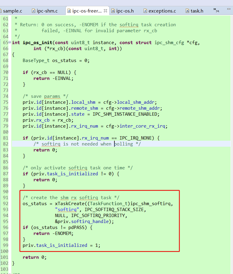

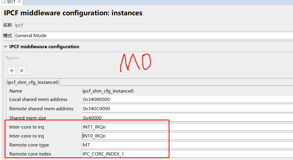

I want use IPCF to realize communication just between CM7_0 and CM7_1.
Both IPCF RX and Tx are using interrupt, like below:
But failed.

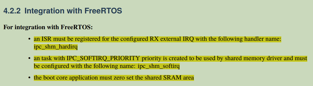

When I see the document of IPCF,I have some questions:
1. I check the ipc_shm_softirq ,but I found the function only create RX softirq task, if I want IPCF tx to use interrupt, need I add another task?

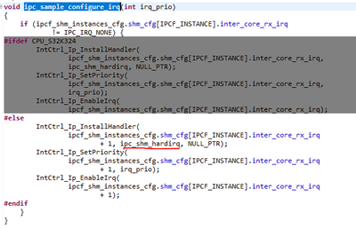

2. Need I register an ISR  for the configured TX external IRQ with the following handler name:
ipc_shm_hardirq????

As for the hardirq, we see that there is a definition under the "IPCF_Example_multi_instance_S32G274_M7_0" example:
Which is already provided. As for the TX interrupt, there is no indication over this, the only one mentioned is the RX interrupt handler.
