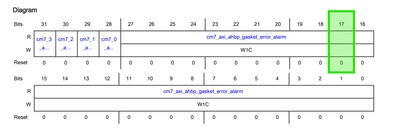

Thanks for reaching out to us. Regarding your problem, Can you share the list of errors you are passing in the first argument of sCheck_AhbTest_CM7? This is, sCheck_ErrorContainerType * pErrorContainer, I ask this, because as per your post, you expect the bit 0x0002_0000 (bit 17), which is a read only bit (with write-1-clear config) in the Cortex-M7 AXI Parity Error and AHBP Gasket Error Alarm (CM7_AXI_AHBP_GASKET_ERROR_ALARM) register:
Can you confirm if your configuration is valid?

Thanks for the information. However, I still don't fully understand your request, After reviweing the code I don't see why are you expecting the register at 0x4007CAFC (CM7_AXI_AHBP_GASKET_ERROR_ALARM) to set its 17th bit:
that part of the register is write-1-clear, therefore, "writing 1" to the register, it will be cleared.
Which is the behavior your are seeing correct?

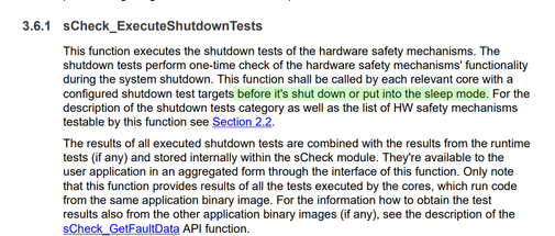

One more question, is there any suggested place where scheck_shutdown tests can be performed in the SHUTDOWN sequence?, Currently, I have kept in EcuM_OnGoOffOne().
2,626件の閲覧回数
alejandro_e
Hello @Irshad2225
Sorry for the very late reply. Regarding your last question, I'm assuming you refer to function sCheck_ExecuteShutdownTests, checking the manual for that particular API function, I don't see any special place in which to put the function:
It only needs to be called before shutting down or going to sleep mode.
