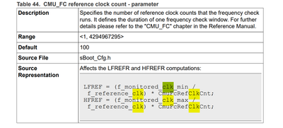

Joey_z
hi,
Thank you for your reply.
Refer to the Manual, The CMU_FC reference clock is 100 in default,it affects the LFREFR and HFREFR computations.
I am checking answer for your other questions.
Joey

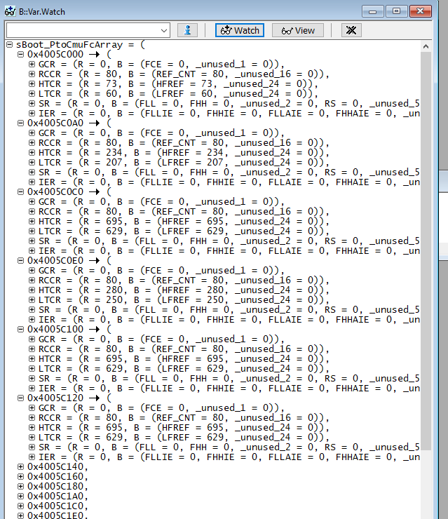

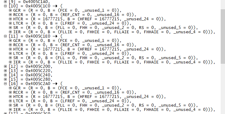

Irshad2225
Hi Joey,
1. As per the user manual, the reference clock count is 100. Configured with 100, when debugged, it's observed that it's being compared with the LREF and HREF values calculated with RCCR-80. attaching snapshot below.
2. For CMU_FC_14, CMU_FC_15, and CMU_FC_21, the LREF and HREF values are too high to match the calculated values. LREF starts with zero, where I have observed that with the minimum frequency as zero, LREF can be 3. The values can be checked in the picture below.

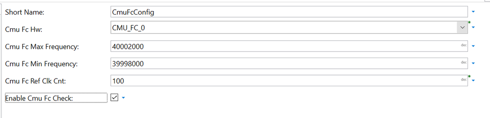

Irshad2225
Hi Joey,
I have configured RCCR as 100 for CMU_FC_0. The HTREF and LTREF are being calculated as per RCCR 100, but the reference is comparing these values with the values calculated with RCCR-80.
Snapshots for configuration and debugger values are provided below.
Refer to the table and the debugger snapshot to differentiate between RCCR-80(reference) and RCCR-100(actual)
CMU_FC_0
LFREF(RCCR - 100) HFREF(RCCR-100)
9176
LFREF(RCCR - 80)HFREF(RCCR-80)
7460
Configuration -
Debugger -

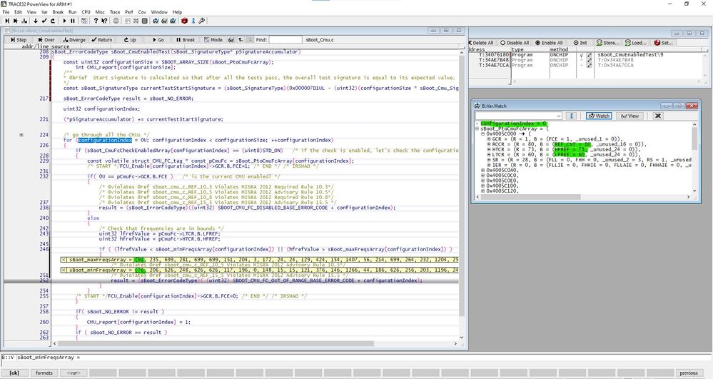

Irshad2225
Hi Joey,
I have set CmuFcRefClkCnt = 100 in Configuration, and the HFREF and LFREF calculations are getting updated as per CmuFcRefClkCnt = 100 in the sBoot_maxFreqsArray and Boot_minFreqsArray.
But, sBoot_maxFreqsArray and Boot_minFreqsArray are being compared with the sBoot_PtocmuFcArray(HFREF and LFREF values calculated as per 80), I think sBoot_PtocmuFcArray should get updated as per the configurations, but it's not happening.
f_reference_clk - 40Hz
4,777 Views
Irshad2225
4,638 Views
