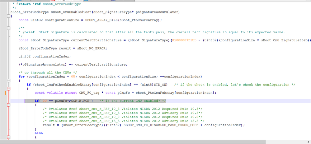

While CMU FC testing in sboot_cmuEnabledTests(), the CMU FC Check shall be True.
For the respective CMU FCs, the pCmu->GCR.B.FCE is not enabled in the plugins while running sboot stand-alone. Should it be done manually? or any prerequisites required?
Working when manually enabling pCmu->GCR.B.FCE.

hi,Irshad2225
Thank you for your information.
You can try to use the sCheck_CmuFc_PrepareRun() function, this function has to enable the frequency check(pCmu->GCR.B.FCE = 1U;).
Hope it can help you.
