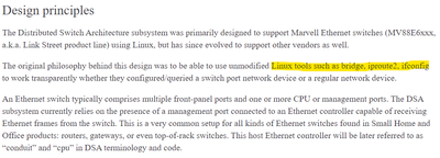

Hello @yangjinzhuang,
Good to read you again.  About your question, there are no specific terminal commands to interact with the SJA1110, there are several software abstraction layers between the SJA1110 driver and the command line utilities. With that said, I recommend you checking the Linux kernel documentation where you can see the following [https://docs.kernel.org/networking/dsa/dsa.html]:
In this case the "switch" mentioned in the docs, is the SJA1110. This means that you can interact with it with the generally supported network commands.

Other resources that you might find useful related to this topic:
https://wiki.linuxfoundation.org/networking/iproute2
http://www.policyrouting.org/iproute2.doc.html#ss9.1
https://wiki.linuxfoundation.org/networking/bridge
https://man7.org/linux/man-pages/man8/ifconfig.8.html
Let me know if this information answers your question.
