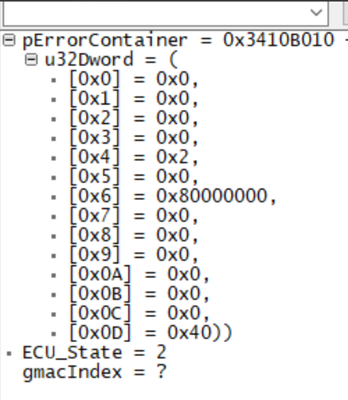

While executing the SCHECK SHUTDOWN test, after all configured tests are performed, I can see the sCheck_ErrorContainer got updated with errors, even though it has performed all the tests with a break in the for loop.
In a readable format, the errors are
  • SCHECK_ERR_SWT0
  • SCHECK_ERR_AHB_CM7_0
  • SCHECK_ERR_DTCM_ECC_M7_0
Observation: After performing AHB_CM7_0 tests, the error container doesn't get updated with SCHECK_ERR_AHB_CM7_0. However, after some tests, it gets updated in the error container.

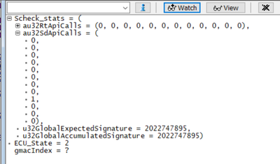

But when the
sCheck_GetFaultData API is called, the accumulated and expected signatures are the same.
Q1. Does the same expected and accumulated signatures mean, all tests got passed, or we cannot relate test results to signature values, only with the error container?

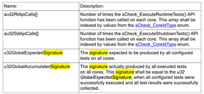

>>This signature shall be equal to the u32 GlobalExpectedSignature, when all configured tests were successfully executed and all test results were successfully collected. You should refer the error container to check the specific fault.

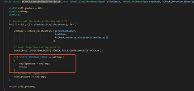

Q2. If any Scheck test fails in between, will it break the loop and exit the function, or will it continue the tests?
>> View the function of sCheck_ExecuteShutdownTests, it uses the sCheck_ExecuteSimpleTestBatch() for the testing batch. And the sCheck_ExecuteSimpleTestBatch only bleak on the SCHECK_INTERNAL_ERROR == u32Temp.

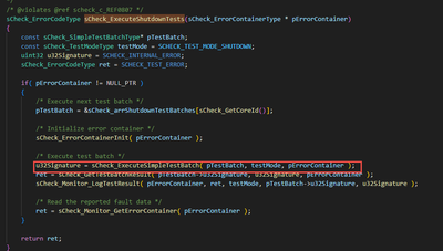

Q3. After each failed test, the error container should be updated at the same time ?
>> Refer to the
 u32Temp = sCheck_CallTestFunc( pErrorContainer,
                                       testMode,
                                       &sCheck_arrTests[pTestBatch->arrTests[i]]
                                     ); function.
Execute all the tests within the batch, will use this function.
