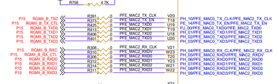

We do not have complete support for the functionality you are mentioning, however, I will try my best to help you. To have better understanding of your setup, can you share the following details:
  • schematics of your board, at least the part that related to the RGMII interconnection between the two SoCs

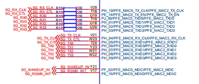

Comparing with the schematics of the S32G-VNP-RDB2 I see that you are using the PFE_MAC2 pins in the opposite way, this is the RX pins as TX pins and vice versa, althought this configuration may work, I cannot assure it. [sheet 14, SPF-47440_E.pdf, S32G-VNP-RDB2-DESIGN-FILES]

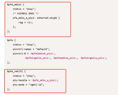

About the device tree, this is an example of how to configure PFE_MAC1 as RGMII, you can use this as base to configure PFE_MAC2 (works with BSP38 and older):
In u-boot:
setenv hwconfig "pcie0:mode=pcie,clock=ext;pcie1:mode=sgmii,clock=ext,fmhz=125,xpcs_mode=2G5"
setenv pfeng_mode 'enable,sgmii,rgmii,rgmii'
setenv s32cc_gmac_mode disable
saveenv
in Linux arch/arm64/boot/dts/freescale/s32g274a-rdb2.dtsi:
//// Comment out original nodes &gmac0_mdio and &pfe_netif1 ////
// &gmac0_mdio {
//     /* AQR107 */
//     gmac_mdio_a_phy3: ethernet-phy@3 {
//         compatible = "ethernet-phy-ieee802.3-c45";
//         #address-cells = <1>;
//         #size-cells = <0>;
//          * Warning: from board rev D it is subject
//          * for eth fixup: addr changed to 0x8
//         reg = <3>;
// &pfe_netif1 {
//     phy-mode = "sgmii";
//     phy-handle = <&gmac_mdio_a_phy3>;
//// Add these new nodes ////
&gmac0 {
    status = "disabled";
&gmac0_mdio {
&pfe_mdio1 {
    status = "okay";
    /* KSZ9031 GMAC */
    pfe_mdio_a_phy1: ethernet-phy@1 {
        reg = <1>;
&pfe {
    status = "okay";
    pinctrl-names = "default";
    pinctrl-0 = <&pfe2mdiob_pins>,
            <&pfe2rgmiib_pins>, <&pfe1mdioa_pins>, <&pfe1rgmiia_pins>;
&pfe_netif1 {
    status = "okay";
    phy-handle = <&pfe_mdio_a_phy1>;
    phy-mode = "rgmii-id";
&pinctrl {
    pfe1mdioa_pins: pfe1mdioa {
        pfe1mdioa_grp0 {
            pinmux = <S32CC_PINMUX(60, FUNC2)>;
            output-enable;
            slew-rate = <S32CC_SLEW_208MHZ>;
        pfe1mdioa_grp1 {
            pinmux = <S32CC_PINMUX(61, FUNC2)>;
            output-enable;
            input-enable;
        pfe1mdioa_grp2 {
            pinmux = <S32CC_PINMUX(857, FUNC2)>;
    pfe1rgmiia_pins: pfe1rgmiia {
        pfe1rgmiia_grp0 {
            pinmux = <S32CC_PINMUX(66, FUNC2)>;
            output-enable;
            bias-pull-up;
        pfe1rgmiia_grp1 {
            pinmux = <S32CC_PINMUX(866, FUNC2)>,
                 <S32CC_PINMUX(859, FUNC2)>,
                 <S32CC_PINMUX(865, FUNC2)>,
                 <S32CC_PINMUX(861, FUNC2)>,
                 <S32CC_PINMUX(862, FUNC2)>,
                 <S32CC_PINMUX(863, FUNC2)>,
                 <S32CC_PINMUX(864, FUNC2)>;
        pfe1rgmiia_grp2 {
            pinmux = <S32CC_PINMUX(67, FUNC2)>,
                 <S32CC_PINMUX(68, FUNC2)>,
                 <S32CC_PINMUX(69, FUNC2)>,
                 <S32CC_PINMUX(70, FUNC2)>,
                 <S32CC_PINMUX(71, FUNC3)>;
            output-enable;
        pfe1rgmiia_grp3 {
            pinmux = <S32CC_PINMUX(72, FUNC0)>,
                 <S32CC_PINMUX(73, FUNC0)>,
                 <S32CC_PINMUX(74, FUNC0)>,
                 <S32CC_PINMUX(75, FUNC0)>,
                 <S32CC_PINMUX(76, FUNC0)>,
                 <S32CC_PINMUX(77, FUNC0)>;
            input-enable;
You can recompile the device tree with:
make -j ARCH=arm64 CROSS_COMPILE=<path-to-your-cross-compiler> dtbs
Let me know the result of the changes.
Alejandro
