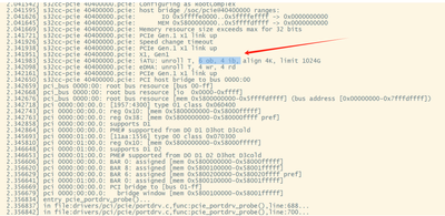

As shown in the figure, please help me. Currently, I am using the S32G399A chip and connecting it to an FPGA via the PCIe interface. In this configuration, the S32G399A acts as the RC and the FPGA acts as the EP. The problem I am encountering now is that the config space of the FPGA can be accessed, but the mem space of bar0 cannot trigger TLP.
The following figure shows the information printed by "dmesg" in the operating system. In the "outbound" section, it shows 6OB and 4IB. How should this outbound and inbound be configured and where should it be configured?

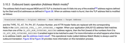

Also, what do Original Address  Base Address  Target Address represent respectively?

From the log shown, there are 6OB windows and 4 IB windows.
1. The number of OB windows and IB windows would often depend on the HW IP, do you think the number of them are enough for you or not? for configure the iatu, you may check the driver under drivers/pci/controller/dwc for your settings.
2.  The Original address could be the address in the request from memory domain, the base Address could be the reference point for the region in the host address space, while target address is the starting point in the PCIe domain.

3. For the snapshot mentioned, which document it referred to?

3.第二张照片是RMS32G3SERDES.pdf,3.10.3章节。
