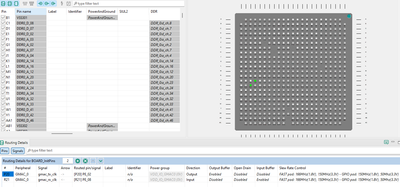

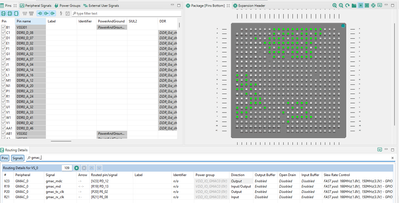

Thanks for the information. Checking the GMAC pin configuration I see you added the gmac_mdc and gmac_md pins configuration, while the GMAC original example (Gmac_Ip_InternalLoopback_S32G399A_M7) includes only the gmac_tx_clk and gmac_rx_clk, also, checking the example's description, from the PHY only the clock is used, for synchronization purposes, and thus, the MDIO pins are not configured.
Original example:
Your configuration:
If you are attempting to use an external you will need to rout it externally, the internal loopback will only "bounce" the mac frames internally, they won't reach the PHY.
