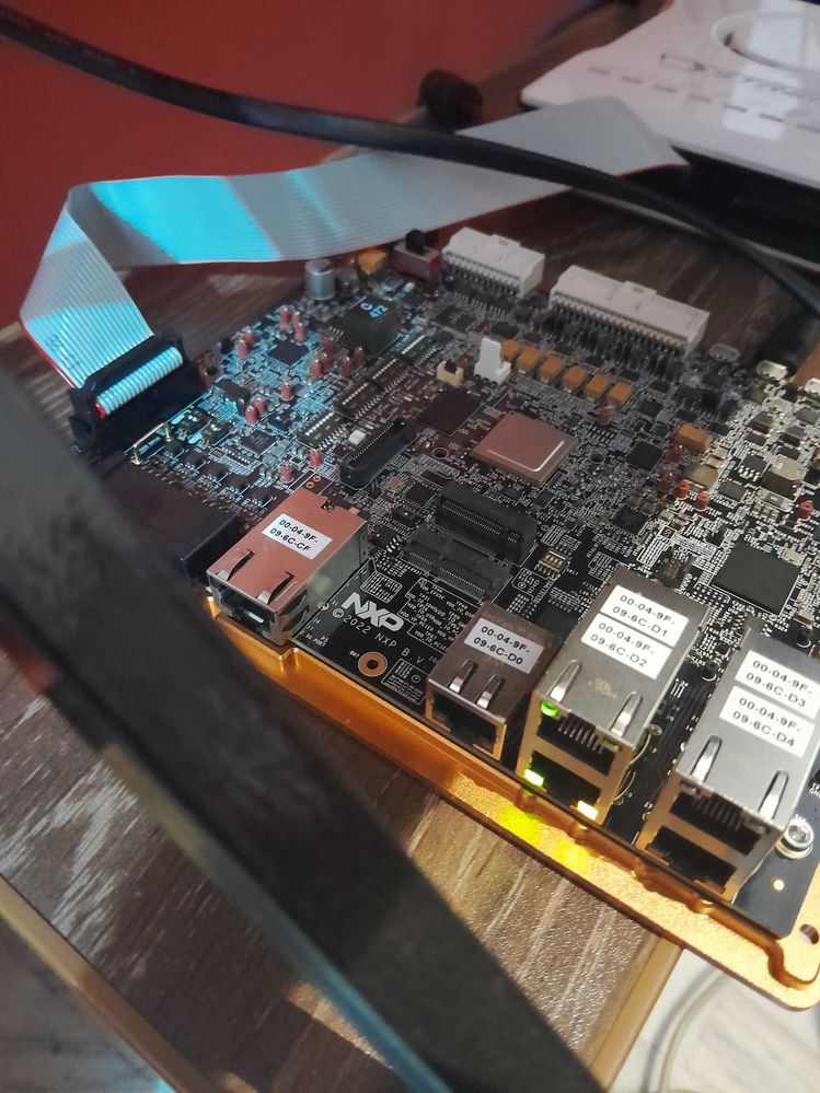

SDK version:
S32 Real-Time Drivers Version 5.0.0 QLP03
TCPIP_STACK for S32G version 2.0.0
Tool version:
S32 Design Studio for S32 Platform
Version: 3.6.4
Build id: 250929
Example:
lwip_FreeRTOS_S32G399A_M7_group lwIP TCP/IP stack
Basic application that presents the lwIP usage with S32G399A RTD
Summary of issue:
The example was built and flashed to QSPI NOR flash using the S32 Flash tool.
But GMAC ping does not work as laptop on the other end never detects the link.
the lights on GMAC are always on which also does not look right.
Need help to be able to test the LWIP demo with FreeRTOS.

Hello, @rizwan_at_disruptdotcom
Thanks for your post.
According to the corresponding document, it is suggested using the following RTD/FreeRTOS packages listed:
Would you mind retesting it with the recommended version?
Chenyin
