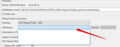

Q1 >> Unable to detect the USB port
[NXP]: Which Debug Probe are you using? If it is S32 Debug Probe, can you see it under the "Device Manager" as follows (or similar):
If so, was the S32 Debug Probe already connected when you enter the specific window? If not, you need to click the refresh button for the GUI to scan for newly connected devices.

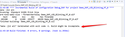

Q3 >> unable to complete the demo code blinking LED.getting the below error.
[NXP]: Which demo are you following? Can you help us elaborate on the different steps you have followed? Which RTD version are you using?

Hi @Daniel-Aguirre ,
WHen i connected (Micro USB cable)One side is connected to PC and another side connected to J2(UART0)
Pls find the pic--It is detected as USB serial PORT

3)I have followed this below method as suggested by you
https://community.nxp.com/t5/S32-Design-Studio-Knowledge-Base/HOWTO-Create-a-Blinking-LED-applicatio...

Q1 >> WHen i connected (Micro USB cable)One side is connected to PC and another side connected to J2(UART0)
[DA]: This connection is a serial port, not for debugging. UART0 is not a debug port, hence it is not shown under the debug window.

Q3 >> I have followed this below method as suggested by you
[DA]: Which RTD version are you using? Can you help us elaborate on the different steps you have followed? We have done this demo with multiple versions and have not seen this message shown on our side.

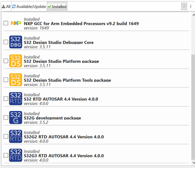

RajCS
1)Connected USB cable to J4-USD for debugging
2)I dont have idea on SD card
3)Pls find the RTD version
S32 RTD autosar 4.4 Version 4.0
S32G2 RTD autosar 4.4 Version 4.0
S32G3 RTD autosar 4.4 Version 4.0
[DA]: We don't see any J4-USD connector under the NXP reference boards. Can you help us elaborate on which specific evaluation board are you using?
[DA]: Can you help us elaborate on the different steps you have followed? We have done this demo with RTD v4.0.0 and cannot see this message shown on our side.
Please, let us know.

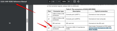

RajCS
Hi Daniel,
Board name is S32G-VNP-RDB3.Sorry it is J4 USB

Daniel-Aguirre
Thanks for your feedback.
As told under the RDB3 Reference Manual, J4 is for USB Host/Device functionality, not for debugging nor flashing.
We might be misunderstanding the overall inquiry, if so we do apologize. We can recommend looking into the SW Enablement Training available under the RDB3 product page (link: S32G3 Vehicle Networking Reference Design | NXP Semiconductors). In there, you should be able to better understand the first steps and the required ports in order to flash your device.
As if SD card is necessary to flash a program, unless you are trying to boot the platform with the SD interface, it is not. You should be able to use the available QSPI flash available under the RDB3. More information on regards of the different boot interfaces for RDB3 can be found under the S32G3 RM [Page 1347, S32G3 Reference Manual, Rev. 4, 02/2024].
