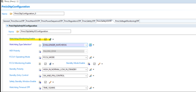

im  trying to implement PMIC watchdog on S32G3, i have multiple questions like:
1. with OTP configuration, is the OTP things done only on the production phase or is it possible to do something on development phase?? because i see OTP related configuration in EB Tool. For Eg. configuring the watchdog type (simple/Challenger)? are those coming into picture during development phase?
2. Regarding Watchdog i see default configuration for PMIC internal watchdog is challenger watchdog. configuration wise i have configured to simple watchdog to keep things simple without Q/A. but my question is this configuration coming into picture because as it's an OTP configuration related.

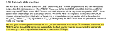

Major Issue: PMIC watchdog refresh doesn't happen. During Pmic_InitDevice-> Pmic_TriggerWatchdog. when debugging. after filling the buffers that are sent via I2C (data: seed value along with CRC) debugger gets detached, leaving no way for debugging.
what i suspect is the configuration i have done from challenger to simple watchdog is taking not effect so when I'm trying to write seed while trigger watchdog. the above-mentioned behavior is happening. please correct me if im wrong.

i am using Pmic_Configuration_Autosar_Example_S32G399A_M7. and enabled watchdog as shown in below SS
is it still necessary to integrate/configure Wdg_VR5510(Wdg_43_VR5510_TS_T40D11M40I2R0) along with PMIC(Pmic_TS_T40D11M40I2R0) for first good watchdog refresh which put PMIC to normal_Fs state?

i am using the default configuration by integrating PMIC_init and PMIC_initdevice from the RTD example. so, in the PMIC_initdecive-> PMIC_triggerwatchdog is called to trigger the watchdog for the first time which closes the INIT_FS and puts the PMIC to normal state. but in my case the First trigger doesn't happen before which the debugger detach happens.
