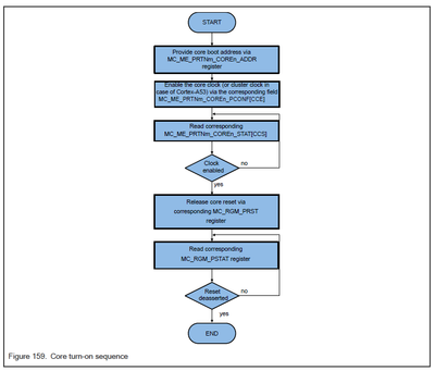

Overall, on regards of multicore applications, M7_0 (in this particular case) should provide the start address of M7_1 to the MC_ME module, then deassert the RST of M7_1. More information is available under the S32G3 RM [Page 1258, S32G3 Reference Manual, Rev. 4, 02/2024]:

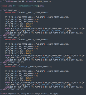

Also, on regards of the example, the code for setting/starting up M7_1 from M7_0 is provided under the system.c file, as follows:

1. In this example of the function "Sys_StartSecondaryCores", the macro definition START_CM7_1 is not defined, so how to go about the next steps.
2. According to your explanation just now and the content of the reference manual, can I understand that CM7_1 is enabled by CM7_0, and only the CM7_1 starting address and clock configuration are provided in CM7_0, and then the reset is completed

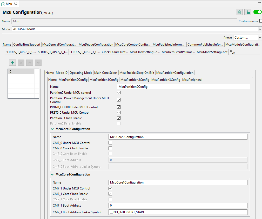

[DA]I: t does seem to be that the enablement of the M7_1 is being done under the Mcu_SetMode(McuModeSettingConf_0); function. This given the following configuration under the Mcu peripheral:

In general, as seen under the flow chart of the RM, you need to provide an address, enable the clock then deassert the reset of the respective core. This enablement flow is the same for all the available cores inside the S32G3 chip [Page 1256, S32G3 Reference Manual, Rev. 4, 02/2024]:
"This sequence can be used to turn on the Cortex-M7 application cores or the Cortex-A53 cluster cores."

jiajun
According to your description CM7_1 initialization is done in this function "Mcu_SetMode(McuModeSettingConf_0)", then what are the two parameters "CM7_0 Under MCU Control & CM7_0 Core Clock Enable"? What do these two parameters mean, check or don't check respectively represent what function, please explain, thank you!
