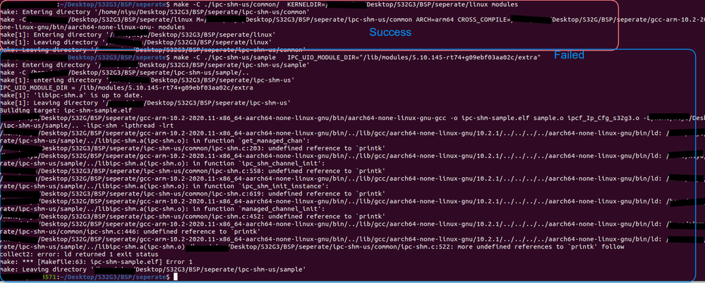

but the following command failed
make -C ./ipc-shm-us/sample IPC_UIO_MODULE_DIR="/lib/modules/5.10.145-rt74+g09ebf03aa02c/extra"

Hi Ni Yu
Hope you are doing well
Thanks for reaching to us. There may be sample.c  compiles as user environment and uses ipc-shm.o which compiled for module. can you try below things
make -C ./ipc-shm-us/ clean
and let us know if not solved

3,231 Views
Coco111
It takes effect, thank you very much. It's a problem with the ipc-shm. o file

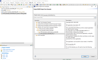

Step1: Compile IPCF_Example_S32G399_M7_0_demo.bin
Step2: Compile ipc-shm-dev.ko &&ipc-shm-sample.ko
