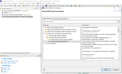

Step1: Compile IPCF_Example_S32G399_M7_0_demo.bin

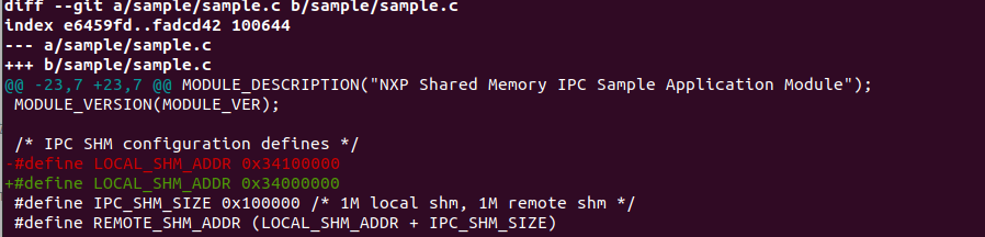

make -C ./ipc-shm/sample PLATFORM_FLAVOR=s32g3 KERNELDIR=$PWD/linux modules
Note: Modification of ipc-shm (Is this a source code error?)

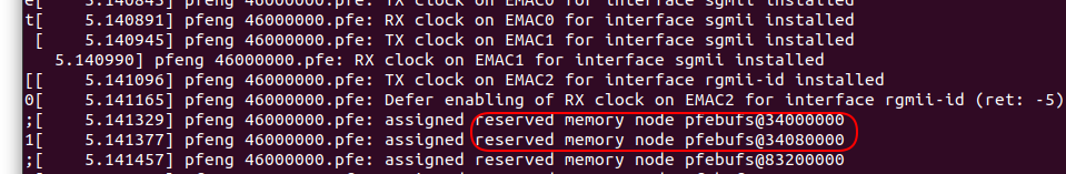

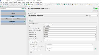

I realized that the PFE driver may interfere with the IPCF, so I adjusted the IPCF to use 0x34100000 (1M) 0x34200000 (1M) as the data interaction space. However, the system is in a stuck state, possibly due to the inability to obtain interrupts
ipc-shm demo

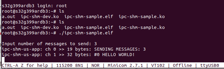

ipc-shm-us demo
I have currently checked the IPCF version, shared SRAM address, and possible conflicts.
But there are still issues, please help me. How should the s32g399 platform use this demo
