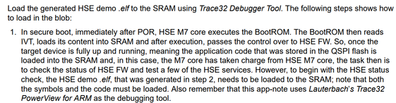

Hello @SahaarA,
If I understood your problem correctly, you should be able to load and debug an application using the crypto services following the instructions in  AN14070 - How to Run HSE Demo Application, please check section How to load the HSE demo .elf to the SRAM.
Let me know if this information solves your problem.
